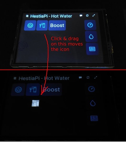

HABPanel Icons Click & Drag moves the icon
This was fixed for some time but it came back.
If you use a small touch LCD like 3.5" and you find yourself dragging the icon buttons all the item instead of tapping them here is a workaround with CSS (at least for Chromium).
