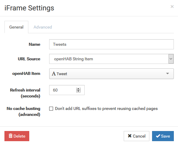

However, I wanted to include the same information in the main screen of my Habpanel visualization. Therefore I created a widget iFrame:

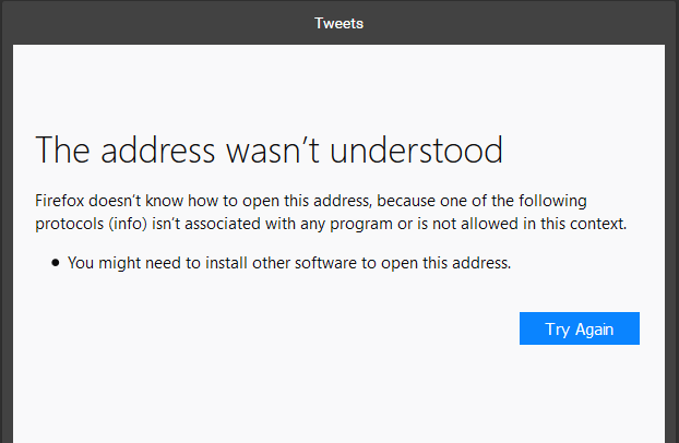

When I run the widget in Firefox I’m getting this error message:

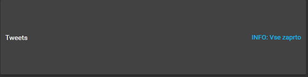

It works if I use a Dummy widget:

If the item Tweet contains an URL you can use an iframe. If it contains just the Tweet, use dummy instead.
