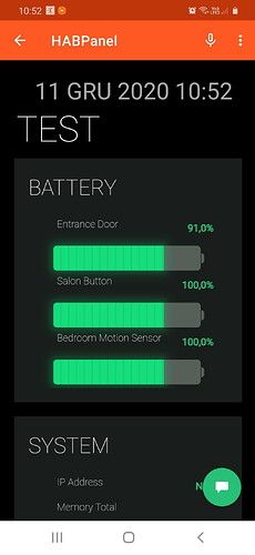

However I faced some problem: Android responsiveness more precisely scrolling on mobile either using PWA version and installed android app.
Here it is how it looks like:

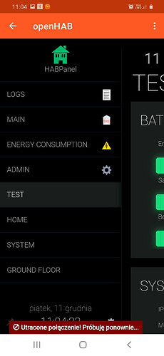

I can’t scroll it down, I can swipe left and menu with dashboards can be seen. Like this:

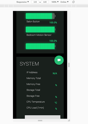

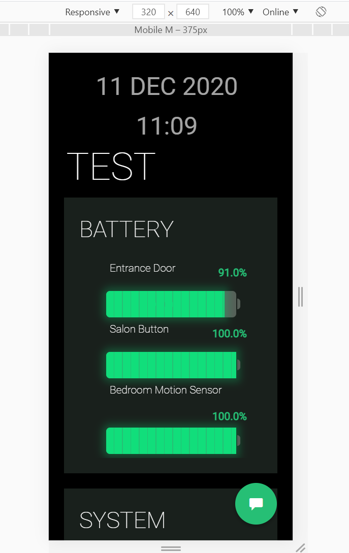

However on desktop I can do it using developer tools using mouse wheel (not by swiping down):
