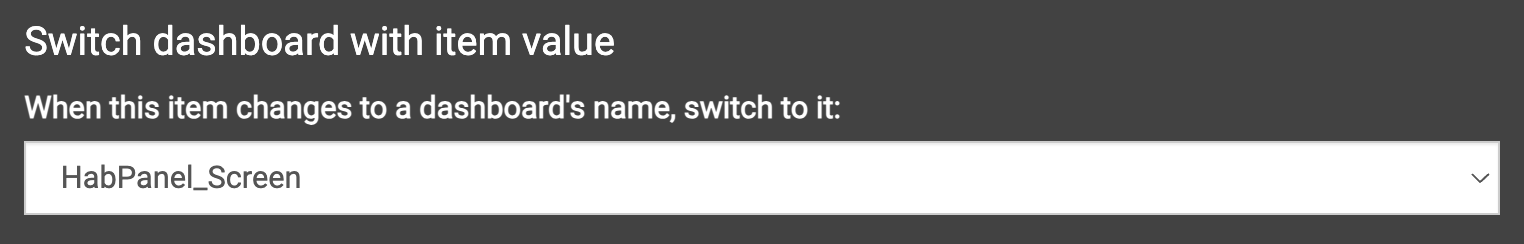

HabPanel allows OH to control the currently displayed Dashboard using one of the panel settings:
It is usually defined as an item such as:
String HabPanel_Screen "HabPanel Screen" <screen> (VirtualSwitch)
The idea is that changing the content of the string, HabPanel will switch to that Dashboard, should the string match an existing Dashboard. Simple, yet very powerful.
