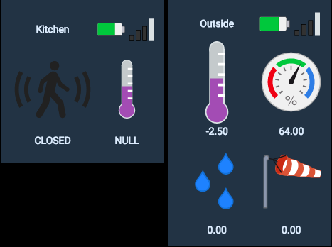

I’ve some other ones in the pipeline, similar to the one I published here for the Nuki Lock, but for multiple sensors. I will try to find some time to optimize them during the weekend and publish them too, and also your corrected version of the printer status.
I also have a 3 row version for 6 devices, I use these for my Aeon Multisensors, Netatmo Stations as well as some Server stats. I will try to understand what you chnaged with the printer widget as these have some similar issues, furthermore I want to make the text somehow “sprintfable” so there is eg “°C” after the temperature or “mm” after the rain or such.

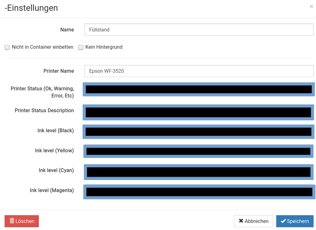

Hello, I would like to install this widget, but I cannot find any instructions. My network printer is Epson WF-3520. Where can I find installation instructions? thx

I need installation instructions for Habpanel PrinterStatus widget! Unfortunately, this cannot be found under the link provided. Why is the widget printer status recommended by openhab in the gallery? So it is useless.

The link provided shows how to add a custom widget. So download the widget from the post above, go to your dashboard and import that widget:
why are you annoyed? I thought I would be helped here. The link is not my problem, it’s the settings.
Can’t help with that as I am not using that widget.
But putting weather items in a printer status widget can’t be right.
I don’t want to insert weather elements either, they are displayed automatically. Any reference to the printer is missing. Therefore I ask for instructions.
PS. Items are usually selected where the weather elements can be seen. But there are no such for a printer. Maybe the developer has an explanation.
thx
You need to find a binding which is able to read your printer data/status/whatever.
Then you need to create Things (for V2 bindings, V1 bindings are a different story), connect the available Channels to Items and those Items need to be selected in the widget.
Usually there is no need to ask the developer for configuring any bindings. What binding are we talking about?
