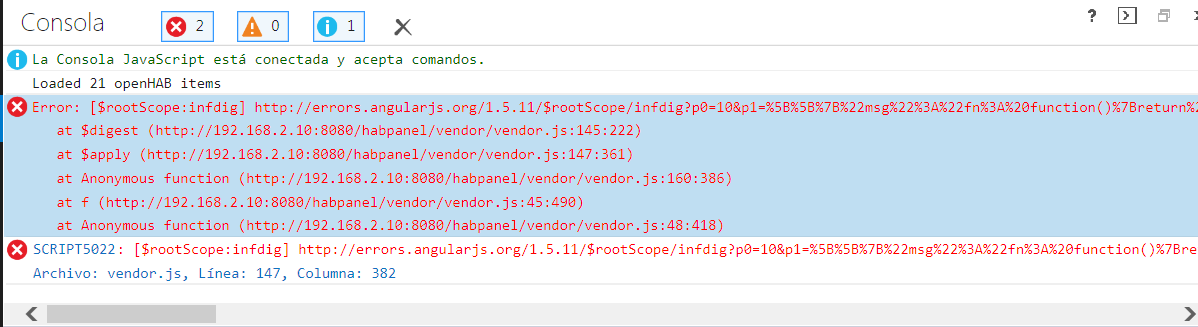

After all night, I can see in Chrome the virtual thermostato UI perfectly (it happened the other day the same). In IE does’nt work yet.
I’ve pasted the java console output in IE, but in Chrome I don’t know how to access to it to compare, I’ve tried F12 without sucess.

Hi Geo,
The line that is wrong for IE is $scope.$watch(() => $ohs.ohs_knobs, function(newKnob, oldKnob)
But I cannot understand the syntax of that line because it is not like the the rest of $scope.$watch.
Regards,
I am not a developer, hence my knowledge is limited. That is an arrow function, which is not supported by IE 11. Could this be fixed with an workaround? Most likely, but as I said I have no intention to spend time to “fix” IE issues, for the time being.
You can try to replace that watch with this piece of code generated by babel:

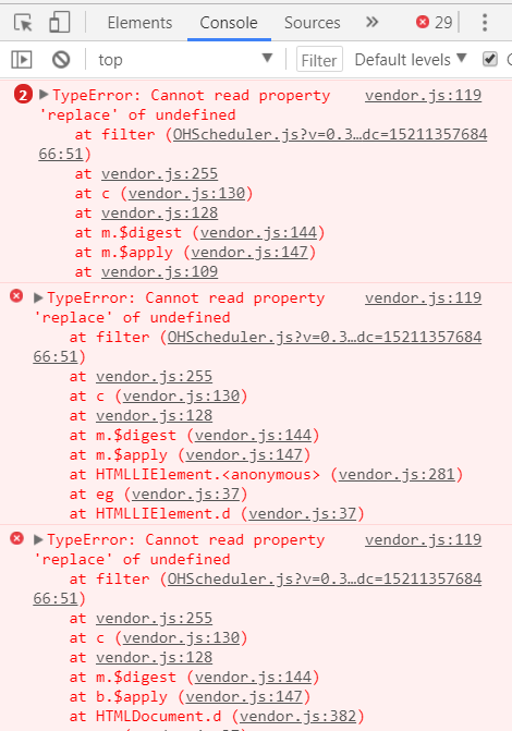

I haven’t tried yet the part for IE but I captured the errors in Chrome whenever I change variables associated with OHSchedule. It seems that after several hours it works. The error is that Chrome does’t find replace function as you can see in the following screenshot:
Any ideas?
@ Pat Rooney it seems the items files has an error. Please note that the lines 11,13 and 15 end with “{}”. There you should put your binding config for the temperature items. If no such binding available, and you want to set the item value manually (e.g. from rules for testing purposes) then you should remove those curly braces.
@ Jose I think the error appears because the state for your RUNNING MODE item is empty. This was already fixed in the next version.
Hi Geo,
Yes, I removed the curly brackets, I knew about it. I thought too about uninitialized variable. I’ll wait for next version.
