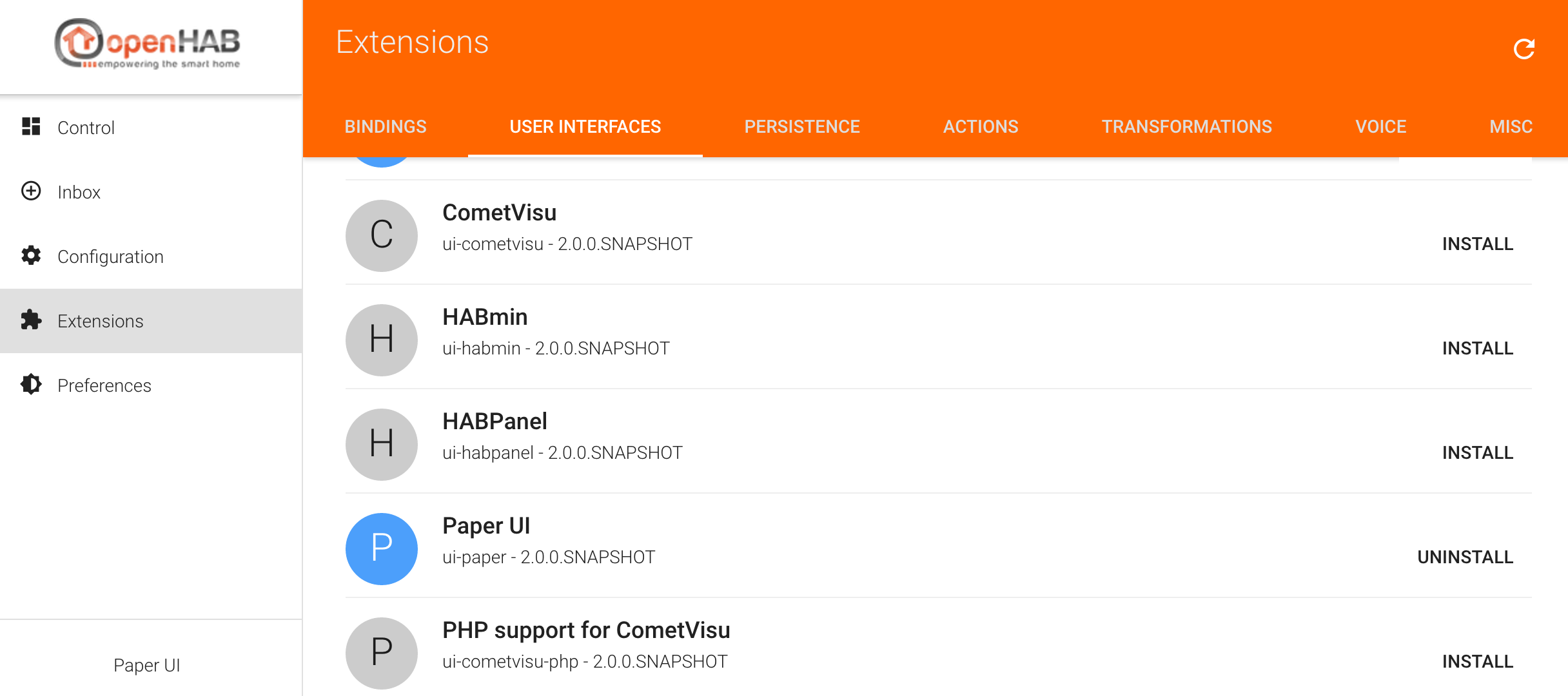

Good news! HABPanel is now added as an experimental feature to the distro. So if you enable “remote repo access” and “experimental features” in Configurations->System in the Paper UI, you will find it listed as a User Interface:
Once people feel that it is mature enough to be used, I’ll happily add it as a standard UI option that even ships with the offline distro.

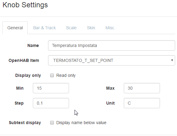

I would like to use a Knob to setup the temperature of my thermostat. I have 0.1 step resolution and i configured widget like this:
It seems it have some issue handling decimal step. When i Reload page with F5, it show 0.0, but if I click on the knob, it show the value and set correct value on openhab. After few second widget round to near integer (if 24.3 round to 24.0) but value on openhab is not changed.
Thanks a lot for support.
Marco
Indeed.
No workaround for now - the primary target is Webkit-based browsers: Chrome, Safari. Firefox seems to work pretty well too.

I think my issue is related to float values. If you want to try setup a Numeric Item, and the on sitemap a setpoint with increments of 0.1
Then link to HabPanel
Marco
Hi, @ysc
I’m checking the code of the widget and seem I found the partial root cause of the issue.
I edited your code in this way:
function getValue() {
            var item = OHService.getItem(vm.widget.item);
            if (!item) {
                //console.log('item ' + vm.widget.item + ' not found');
                return;
            var parts = item.state.split(',');
            var value;
            if (parts.length == 3) {
                // knob received HSB value, use the 3rd (brightness)
                value = (parseFloat(parts[2])).toFixed(1);
            } else {
                value = (parseFloat(parts[0])).toFixed(1);
            return value;
Instead using parseINT i used parseFloat and added toFixed for rounding to 1 decimal.
I’m still with another part of my issue. Refreshing the page from the browser, the widget show 0.
Can you help me on this? Better thing should be edit this Widget and add the capability to add float values, or add another similar widget handling Float values.
Marco
