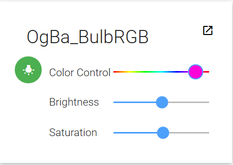

Now i have set the brightness and saturation to the middle. The Lamp shines with color white.
And then i have change the color … see next picture
The Lamp still shines with white color.
Log-Files of this change:
2017-12-29 08:17:13.271 [DEBUG] [ding.zwave.handler.ZWaveThingHandler] - NODE 34: Command received zwave:device:Razberry2:node34:color_color --> 306,52,51
2017-12-29 08:17:13.273 [DEBUG] [ding.zwave.handler.ZWaveThingHandler] - NODE 34: No messages returned from converter
When i change the brightness to nearliy 100%, the log file entries are as follow:
2017-12-29 08:23:53.342 [DEBUG] [ding.zwave.handler.ZWaveThingHandler] - NODE 34: Command received zwave:device:Razberry2:node34:color_color --> 96
