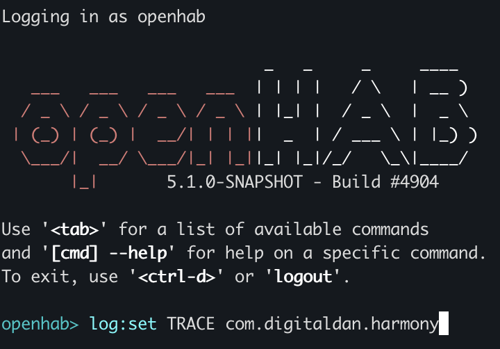

DEBUG or TRACE logs would be helpful. I would pause the Hub thing then unpause it so the logs clearly show whats failing when connecting. For even more logs, i would also turn on TRACE logging for com.digitaldan.harmony , so in the openHAB cli that command would be
log:set TRACE com.digitaldan.harmony
