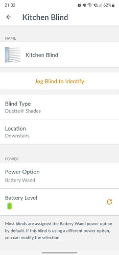

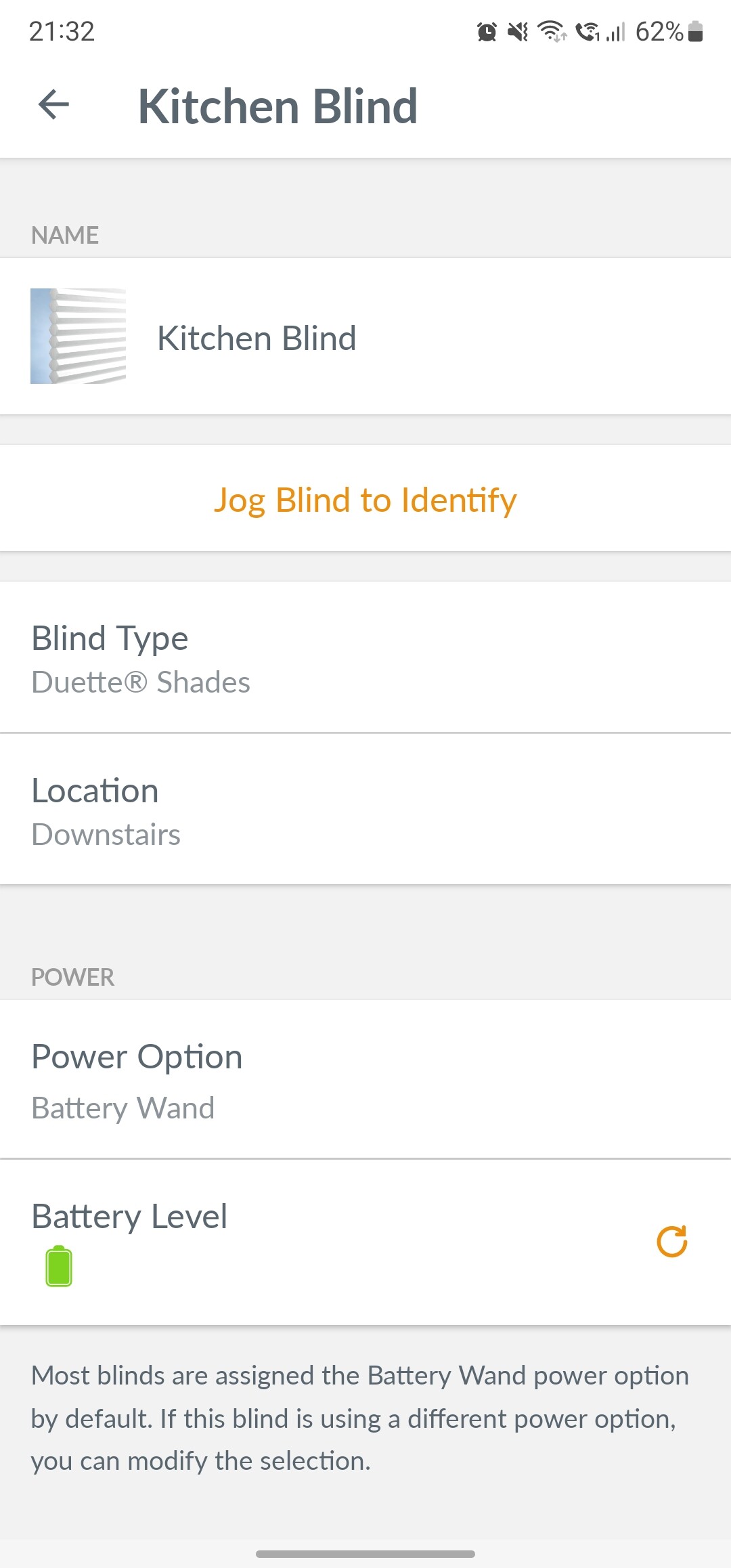

I have Duette shades and once discovered the type of shade has to be manually set within the PowerView app. I cannot see anything in relation to capabilities within the app. Where should I be seeing this?
Thanks as always :slight_smile:

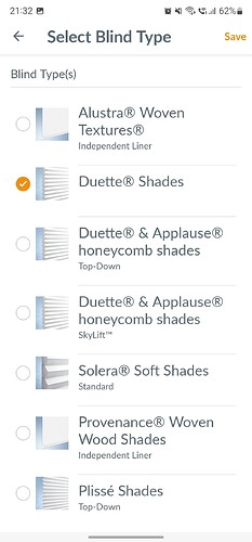

Can you please indicate (screenshot) how you set the type in the App? Is there (say) a dropdown selection? Or do you enter a string (“Duette”)? Or do you enter a number (“42”)?

Please see screenshots below:
Select ‘Blind Type’:
I’ve got normal Duette shades, since the bug logged in December 2021 quoted in the original post I was using the JAR file provided there without any issues. Until I upgraded today to 3.3.0 where I thought all the changes would have been merged into the release, that is when I found out it stopped working…
Hope this helps and as always thanks for the hard work :slight_smile:
Thanks for the screenshots. In the second shot “select blind type”, is that the full list of choices? Or does the list scroll down further? If so can you please screen shot all of the pages with all the choices of shade types?

This is the complete list of choices available to select from in the v1 hub :slight_smile:
Of course I’ll add the screenshots to the created issue :slight_smile:
