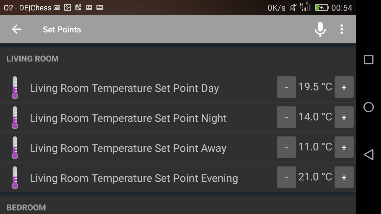

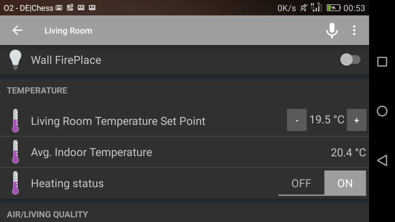

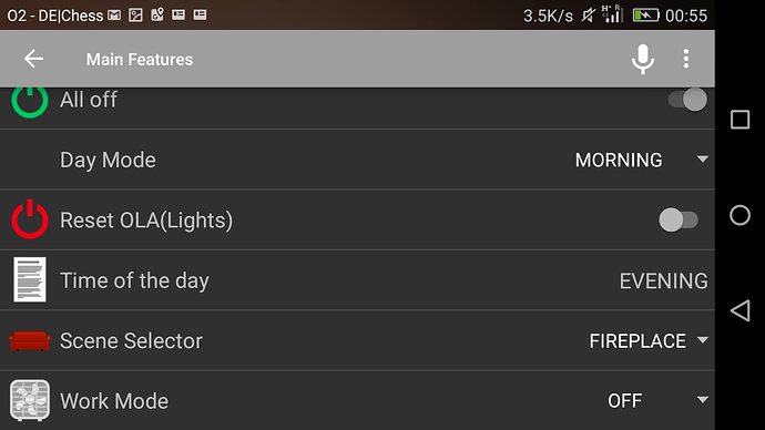

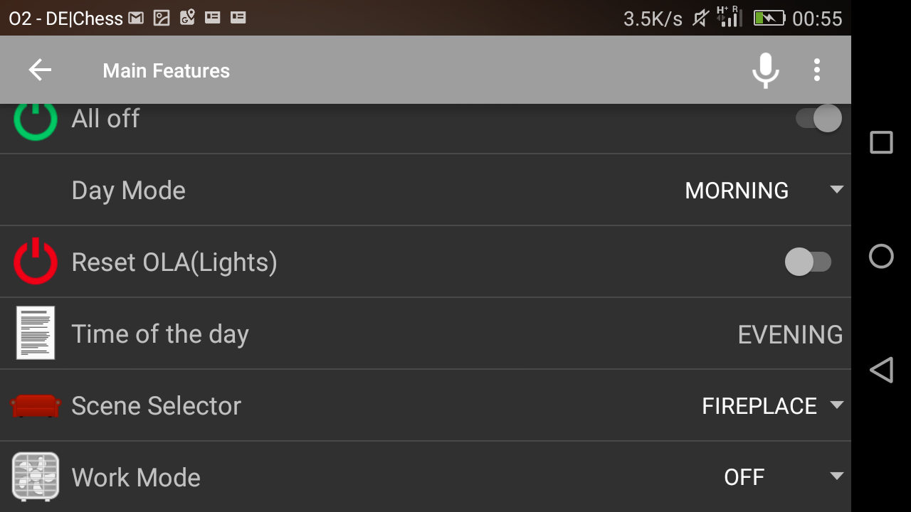

A few screenshot made on the road from my android app and posted here for you guys referance:
Used for debugging and overiding states:
Changing setpoints:
What my sitemap looks like:

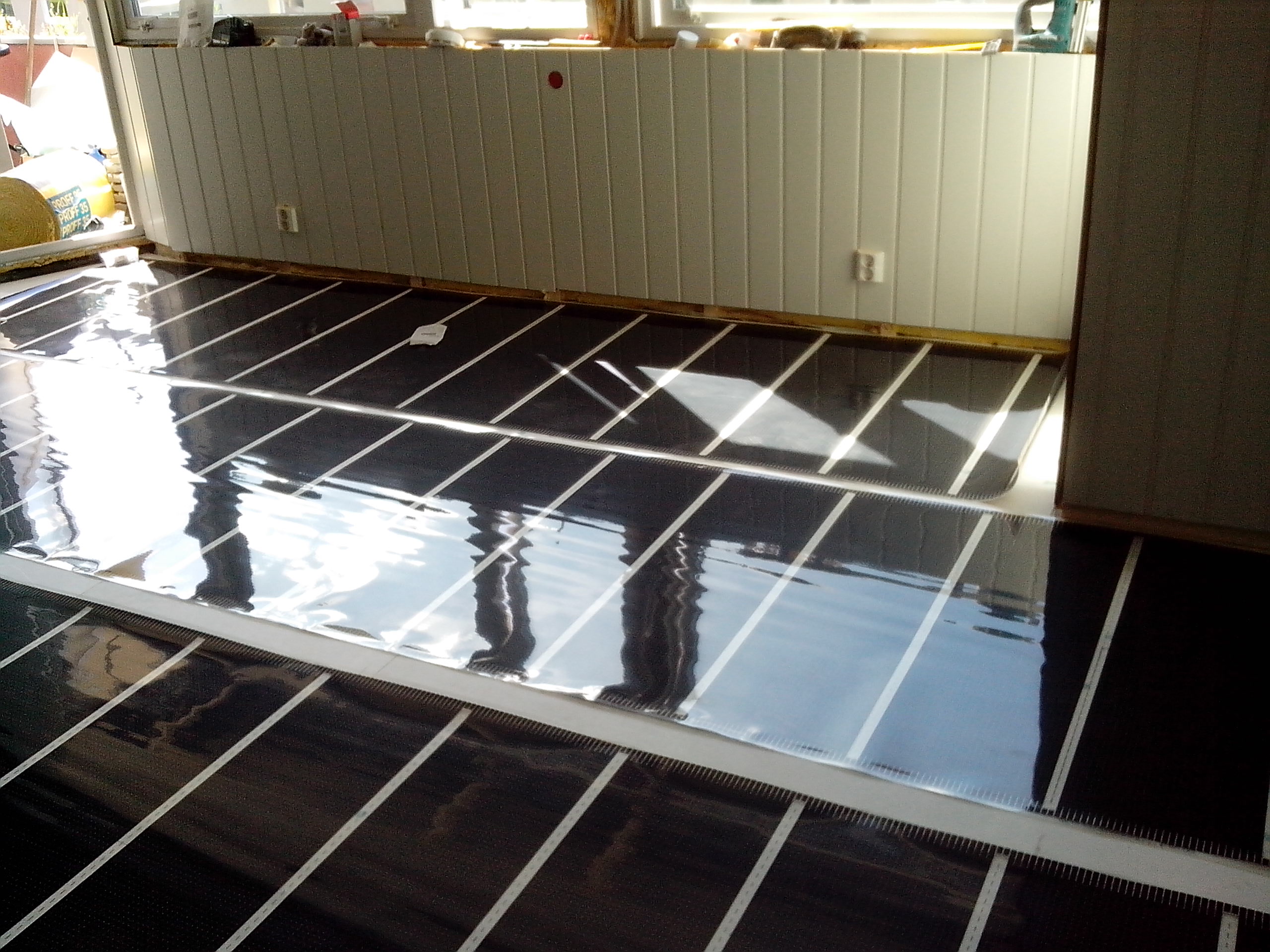

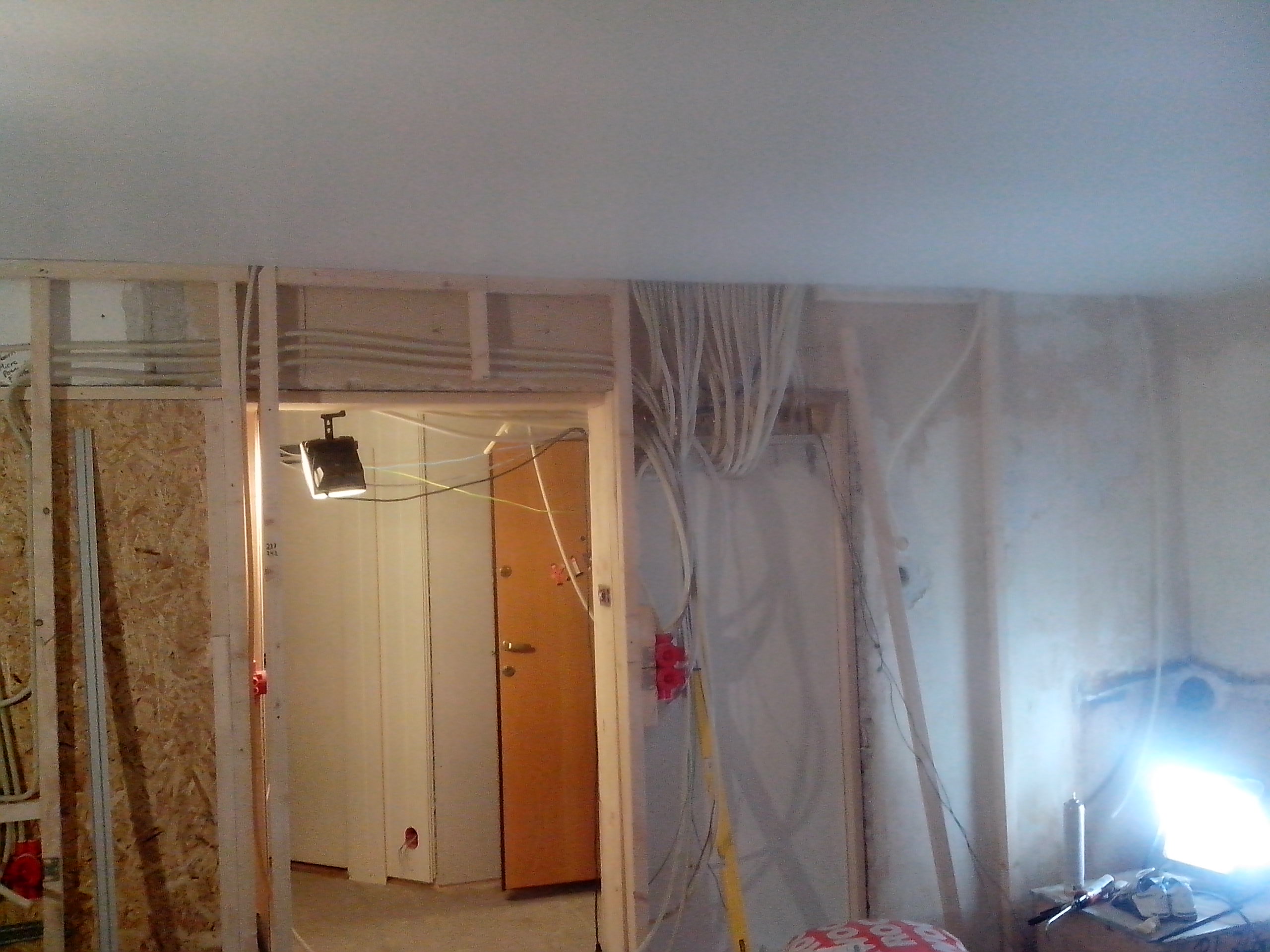

So some more info about my setup, I started renovating our flat completly in 2014, and the reason why I went for OH was mainly because of lighting. I had to start with the ceiling and that was were I needed to put my downlights, and since at that point I had no clear view of how it would be furnished, I figured out that the best way to get started was to decide that I should be able to control each light seperatly, so whenever I finished the flat i could make different scenes as I would. So to do this I went down the road with wiring every single light to the fusebox where it got attached to a dmx controller, this is why I ended up with 82 pipes for electrical stuff in my 70 sqm flat. So that was why I ended up with Openhab! But since I then had Openhab I could also wire all my heating cables to the fusebox as well, so all these are attached to relays connected to RPI. In the beginning(first year or so) these were not programmed and simply just attached to Normally Closed on the relay and they had their own off the shelf thermostat in each sone. Then in 2016 I started to switch them off at night with cron rules in the same way as @ThomDietrich , Then later that year I implemented my own actuator control:
