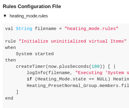

Hi guys,
I have followed this tutorial and it works great, my only issue is when the system restarts its not updating my thermostat setpoints?
Here’s my heating_mode.rules
val String filename = "heating_mode.rules"
rule "Initialize uninitialized virtual Items"
    System started
    createTimer(now.plusSeconds(180)) [ |
        logInfo(filename, "Executing 'System started' rule for Heating")
        if (Heating_Mode.state == NULL) Heating_Mode.postUpdate("NORMAL")
        Heating_PresetNormal_Group.members.filter[item | item.state == NULL].forEach[item | item.postUpdate(21.0)]
rule "React on heating mode switch, send target temperatures"
    Item Heating_Mode received update or
    Item Heating_UpdateHeater received command ON
    Heating_UpdateHeater.postUpdate(OFF)
    logInfo(filename, "Heating Mode: " + Heating_Mode.state)
    switch Heating_Mode.state {
        case "NORMAL": {
			CB_Heating_TargetTemp.sendCommand(CB_Heating_PresetTempNormal.state as Number)
			MB_Heating_TargetTemp.sendCommand(CB_Heating_PresetTempNormal.state as Number)
            LB_Heating_TargetTemp.sendCommand(LB_Heating_PresetTempNormal.state as Number)
			Office_Heating_TargetTemp.sendCommand(Office_Heating_PresetTempNormal.state as Number)
			Ensuite_Heating_TargetTemp.sendCommand(Ensuite_Heating_PresetTempNormal.state as Number)
			Landing_Heating_TargetTemp.sendCommand(Landing_Heating_PresetTempNormal.state as Number)
			Bathroom_Heating_TargetTemp.sendCommand(Bathroom_Heating_PresetTempNormal.state as Number)
			Lounge_Heating_TargetTemp.sendCommand(Lounge_Heating_PresetTempNormal.state as Number)
        case "HOME": {
            CB_Heating_TargetTemp.sendCommand(21.0)
			MB_Heating_TargetTemp.sendCommand(21.0)
            LB_Heating_TargetTemp.sendCommand(21.0)
			Office_Heating_TargetTemp.sendCommand(20.0)
			Ensuite_Heating_TargetTemp.sendCommand(20.0)
			Landing_Heating_TargetTemp.sendCommand(20.0)
			Bathroom_Heating_TargetTemp.sendCommand(20.0)
			Lounge_Heating_TargetTemp.sendCommand(21.0)
        case "WEEKEND_TRIP": {
			CB_Heating_TargetTemp.sendCommand(15.0)
			MB_Heating_TargetTemp.sendCommand(15.0)
            LB_Heating_TargetTemp.sendCommand(15.0)
			Office_Heating_TargetTemp.sendCommand(15.0)
			Ensuite_Heating_TargetTemp.sendCommand(15.0)
			Landing_Heating_TargetTemp.sendCommand(15.0)
			Bathroom_Heating_TargetTemp.sendCommand(15.0)
			Lounge_Heating_TargetTemp.sendCommand(15.0)
        case "AWAY": {
            CB_Heating_TargetTemp.sendCommand(13.0)
            LB_Heating_TargetTemp.sendCommand(13.0)
			MB_Heating_TargetTemp.sendCommand(13.0)
			Office_Heating_TargetTemp.sendCommand(13.0)
			Ensuite_Heating_TargetTemp.sendCommand(13.0)
			Landing_Heating_TargetTemp.sendCommand(13.0)
			Bathroom_Heating_TargetTemp.sendCommand(13.0)
			Lounge_Heating_TargetTemp.sendCommand(13.0)
        case "OFF_SUMMER": {
			CB_Heating_TargetTemp.sendCommand(0.0)
            LB_Heating_TargetTemp.sendCommand(0.0)
			Office_Heating_TargetTemp.sendCommand(0.0)
			MB_Heating_TargetTemp.sendCommand(0.0)
			Ensuite_Heating_TargetTemp.sendCommand(0.0)
			Landing_Heating_TargetTemp.sendCommand(0.0)
			Bathroom_Heating_TargetTemp.sendCommand(0.0)
			Lounge_Heating_TargetTemp.sendCommand(0.0)
        default : { logError(heating_mode.rules, "Heating Mode unknown: " + Heating_Mode.state) }

I’m not sure what I’m missing?
Although I’m getting this log?
2020-04-13 22:31:03.846 [INFO ] [home.model.script.heating_mode.rules] - Executing 'System started' rule for Heating
Might be a bit late but I’ve only just found this thread…
If you are getting that log file entry then OH has reached the
And is stopping because the IF isn’t true.
If that IF isn’t true then the second rule with all the case statements, ie the rule that does your donkey work will never run.
You need to find out what the Heating_Mode state is in start up and then change the IF to match.
