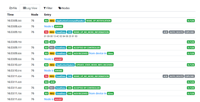

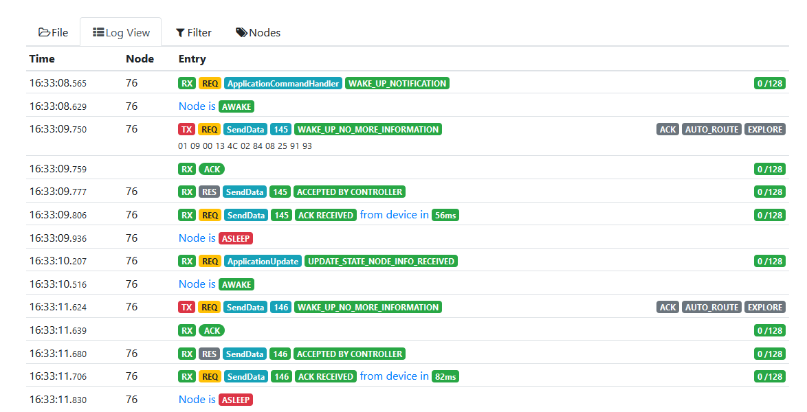

But unfortunately I always get the warning in the log:
Device discovery could not resolve to a thingType! 019B:0300:A306::1.26
The behavior is strange in my opinion, as the device seems to be present in the database (see https://opensmarthouse.org/zwavedatabase/1162)
This is a debug-log of sending the Node Information Frame:
16:33:08.565 [DEBUG] [ZWaveSerialHandler$ZWaveReceiveThread] - Receive Message = 01 08 00 04 00 4C 02 84 07 3E

    16:33:11.680 [DEBUG] [ZWaveSerialHandler$ZWaveReceiveThread] - Receive Message = 01 04 01 13 01 E8
    16:33:11.686 [DEBUG] [rnal.protocol.ZWaveTransactionManager] - Transaction SendNextMessage 1 out at start. Holdoff false.
    16:33:11.698 [DEBUG] [rnal.protocol.ZWaveTransactionManager] - processReceiveMessage input 0<>128 : Message: class=SendData[19], type=Response[1], dest=255, callback=0, payload=01
    16:33:11.706 [DEBUG] [ZWaveSerialHandler$ZWaveReceiveThread] - Receive Message = 01 07 00 13 92 00 00 02 7B
    16:33:11.705 [DEBUG] [rnal.protocol.ZWaveTransactionManager] - Received msg (0): Message: class=SendData[19], type=Response[1], dest=255, callback=0, payload=01
    16:33:11.711 [DEBUG] [rnal.protocol.ZWaveTransactionManager] - processReceiveMessage input 0<>128 : Message: class=SendData[19], type=Request[0], dest=0, callback=146, payload=92 00 00 02
    16:33:11.714 [DEBUG] [rnal.protocol.ZWaveTransactionManager] - lastTransaction TID 581: [WAIT_RESPONSE] priority=Immediate, requiresResponse=true, callback: 146
    16:33:11.720 [DEBUG] [rnal.protocol.ZWaveTransactionManager] - Checking outstanding transactions: 1
    16:33:11.725 [DEBUG] [rnal.protocol.ZWaveTransactionManager] - Last transaction: TID 581: [WAIT_RESPONSE] priority=Immediate, requiresResponse=true, callback: 146
    16:33:11.730 [DEBUG] [ave.internal.protocol.ZWaveController] - Incoming Message: Message: class=SendData[19], type=Response[1], dest=255, callback=0, payload=01
    16:33:11.735 [DEBUG] [ol.serialmessage.SendDataMessageClass] - NODE 76: sentData successfully placed on stack.
    16:33:11.740 [DEBUG] [rnal.protocol.ZWaveTransactionManager] - TID 581: Advanced to WAIT_REQUEST
    16:33:11.746 [DEBUG] [rnal.protocol.ZWaveTransactionManager] - NODE 76: TID 581: Transaction not completed
    16:33:11.751 [DEBUG] [rnal.protocol.ZWaveTransactionManager] - Received msg (0): Message: class=SendData[19], type=Request[0], dest=0, callback=146, payload=92 00 00 02
    16:33:11.758 [DEBUG] [rnal.protocol.ZWaveTransactionManager] - lastTransaction TID 581: [WAIT_REQUEST] priority=Immediate, requiresResponse=true, callback: 146
    16:33:11.761 [DEBUG] [rnal.protocol.ZWaveTransactionManager] - Checking outstanding transactions: 1
    16:33:11.767 [DEBUG] [rnal.protocol.ZWaveTransactionManager] - Last transaction: TID 581: [WAIT_REQUEST] priority=Immediate, requiresResponse=true, callback: 146
    16:33:11.773 [DEBUG] [rnal.protocol.ZWaveTransactionManager] - Checking TID 581: (Callback 146)
    16:33:11.778 [DEBUG] [l.serialmessage.ZWaveCommandProcessor] - Callback match!
    16:33:11.782 [DEBUG] [rnal.protocol.ZWaveTransactionManager] - Correlated to TID 581: callback 146
    16:33:11.786 [DEBUG] [ave.internal.protocol.ZWaveController] - Incoming Message: Message: class=SendData[19], type=Request[0], dest=0, callback=146, payload=92 00 00 02
    16:33:11.791 [DEBUG] [ol.serialmessage.SendDataMessageClass] - NODE 76: SendData Request. CallBack ID = 146, Status = Transmission complete and ACK received(0)
16:33:11.797 [DEBUG] [ing.zwave.internal.protocol.ZWaveNode] - NODE 76: resetResendCount initComplete=true isDead=false
16:33:11.804 [DEBUG] [ve.internal.protocol.ZWaveTransaction] - TID 581: Transaction COMPLETED
16:33:11.808 [DEBUG] [rnal.protocol.ZWaveTransactionManager] - NODE 76: Response processed after 158ms
16:33:11.812 [DEBUG] [rnal.protocol.ZWaveTransactionManager] - NODE 76: TID 581: Transaction completed
16:33:11.818 [DEBUG] [rnal.protocol.ZWaveTransactionManager] - NODE 76: notifyTransactionResponse TID:581 DONE
16:33:11.822 [DEBUG] [nding.zwave.handler.ZWaveThingHandler] - NODE 76: Got an event from Z-Wave network: ZWaveTransactionCompletedEvent
16:33:11.822 [DEBUG] [rnal.protocol.ZWaveTransactionManager] - TID 581: Transaction event listener: DONE: DONE ->
16:33:11.826 [DEBUG] [rnal.protocol.ZWaveTransactionManager] - ZWaveReceiveThread queue empty
16:33:11.830 [DEBUG] [ing.zwave.internal.protocol.ZWaveNode] - NODE 76: Went to sleep COMPLETE
16:33:11.835 [DEBUG] [rnal.protocol.ZWaveTransactionManager] - Transaction SendNextMessage 0 out at start. Holdoff false.
