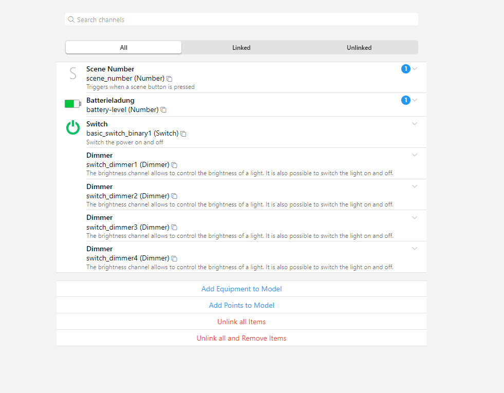

I am using several Heatit Z-Push 8 buttons in my setup. I have configured them all with just 2 channels, on the scene number and the battery level. In respective rules, the system reacts to changes on the scene number. All good with that.
Now I realized (not sure if that was there before or not) that I can only create channels for each of the button pairs. I played around a bit with that, but get no changes on these when buttons are pressed.

maybe, my question was not clear enough. The channels I have created for the Scene Number and Batterlieladung are working fine. But when I create channels for the Switch and the four Dimmers, nothing is happening.

The dimmer channels / items are not triggered at all.
I tried to set an association to another device, but this did not resolve this point.
