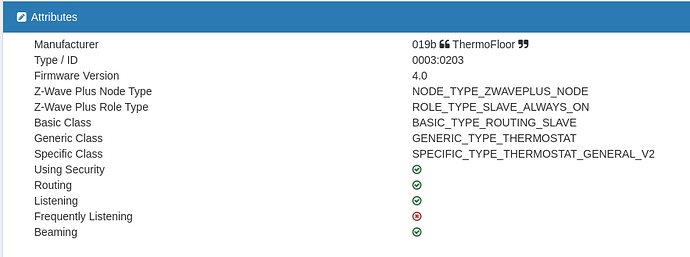

I recently included a Heatit Z-TRM3 thermostat, but it only shows up as an “Unknown Device”. All attributes look correct, and appear to match the database entry: OpenSmartHouse Z-Wave Device Database
I really don’t know how to start debugging this. Any ideas?
