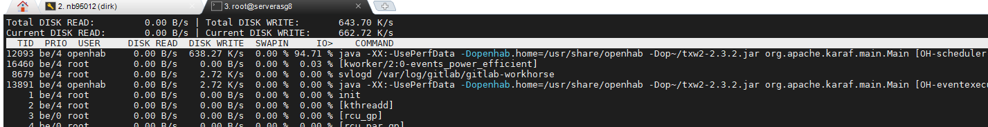

On my installation is heavy I/O on harddrive, most times more than 95% usage.
Screenshot of IOTOP
iotop_openhab
I have no suggestion how this happens.

@Dirk_Neupert, try using the lsof command to see which files the Java process is writing to. Then watch those files over a brief period of time to see which one(s) are growing the fastest. From there we can start to narrow the problem down. It very well may be rrd4j that is causing the problem. But I at least will need a bit more evidence before I blame it.
