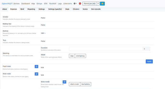

This is Leo from Shenzhen Heiman Technology Co., Ltd. we started a new team to focus on the experiences for DIY users, we’ve got a lot of feedback of adding more functions to our smoke alarm, like the mute alarm, remote test and interconnection, etc, and now, here we are …
we are going to start with our zigbee smoke alarm which model named HS1SA, if you guys love it, we will do these updates to more models of our smoke and CO sensors. including our matter smoke and co alarms, but now, we can only do that with Home assistant.

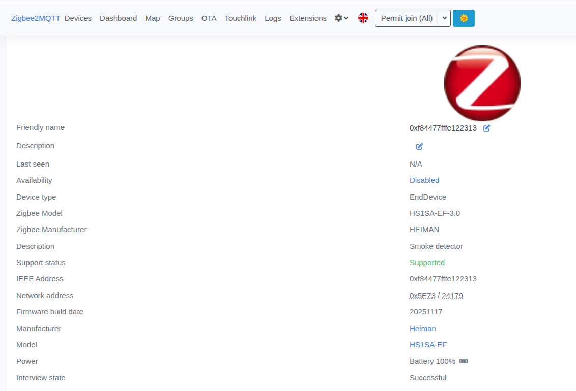

So here is the engineering sample that we have added to Zigbee2mqtt, if we can get your suggestion and proposal, that would be a great honor to us, we would appreciate your advice, we are all ears.

Great approach! It would be really useful if the smoke detector could also function as an alarm siren, so the alarm sound could be activated and deactivated via Zigbee. This would make it more versatile for home security and automation scenarios.

Generally as @mpmario pointed out the feature to use the smoke detector as a siren would be great.

Thank you for commenting, yeah, we got a lot feedback regarding this, but the downside is it will consume more battery energy, we will try to make still work more than two years.

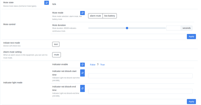

Great to see Heiman actively engaging with the DIY community and working on these improvements! I currently have 6 of your HS1SA smoke alarms deployed throughout my house, and they’ve been working reliably with Zigbee2mqtt.

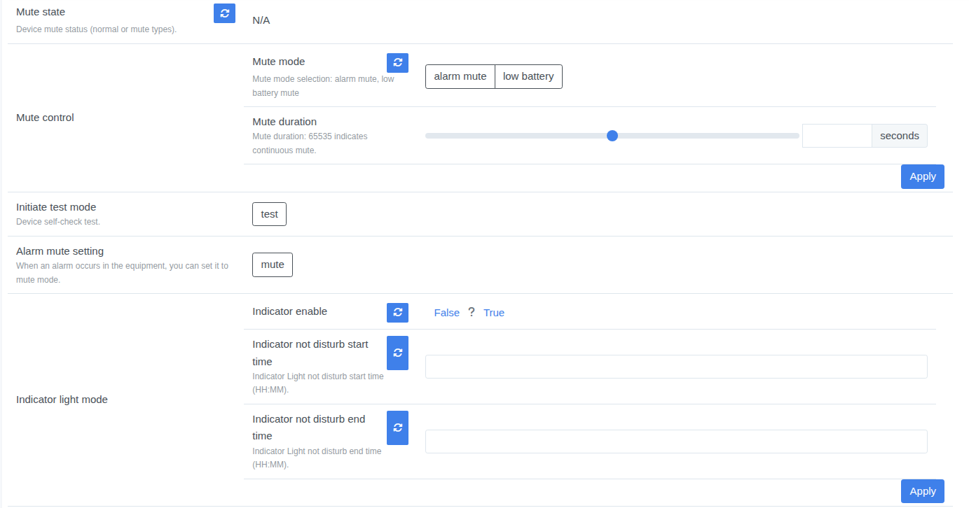

I’m particularly interested in the “indicator enable/disable” feature shown in your screenshots. This has actually been the one missing feature that prevented me from using the HS1SA in our bedroom - I had to switch to a different model there because my wife finds the blinking LED light disturbing at night.

  • Is the indicator control feature already available in the current firmware, or is this coming in a future update?
  • If it’s already available, could you provide guidance on how to perform an OTA firmware update through Zigbee2mqtt to get this functionality?
  • Will this control allow complete disabling of the LED, or just dimming/adjusting the frequency?
If you can add this feature to the HS1SA, I would definitely consider switching our bedroom back to your model.

Hi Andreas,
Yes, it can be switched off all the time, we leave the option to users, so it’s totally up tp users.
I posted the functions here:
It requires new hardwire, it now works with Z2M, so I assume it will also work OpenHab, I have installed OpenHAB, if someone can guide me how to use it would be wonderful, lol.
