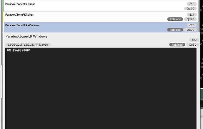

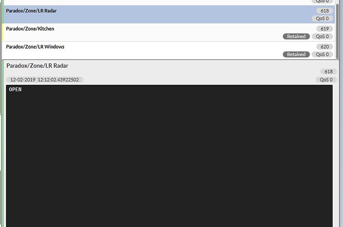

What i mean is that for a specific zone i get as payload OPEN/CLOSE although for another, i get ON/OFF with a number after it. See the attached images.
Ok so for a payload like for Paradox/Zone/LR/Windows you will need a JS transform to extract the value
I assume that ON will be OPEN and OFF closed
Create a file called paradox_windows.js in your transform folder with the following content:

Make sure the JS (Javascript) transformation in installed in the paperUI
Use the transformation for CONTACT items as it returns OPEN and CLOSED
Thanks!!! Its working great!!!
