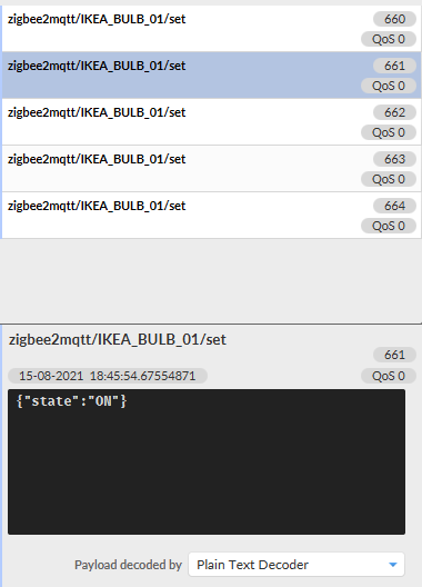

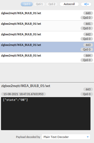

But on the MQTT.fx I see this massage:
{"level":"error","message":"Publish 'set' 'state' to 'IKEA_BULB_01' failed: 'Error: Command 0x60a423fffef36a2e/1 genOnOff.on({}, {\"timeout\":10000,\"disableResponse\":false,\"disableRecovery\":false,\"disableDefaultResponse\":false,\"direction\":0,\"srcEndpoint\":null,\"reservedBits\":0,\"manufacturerCode\":null,\"transactionSequenceNumber\":null,\"writeUndiv\":false}) failed (SREQ '--> AF - dataRequest - {\"dstaddr\":6032,\"destendpoint\":1,\"srcendpoint\":1,\"clusterid\":6,\"transid\":54,\"options\":0,\"radius\":30,\"len\":3,\"data\":{\"type\":\"Buffer\",\"data\":[1,98,1]}}' failed with status '(0x10: MEM_ERROR)' (expected '(0x00: SUCCESS)'))'"}
When I publish ON or OFF on zigbee2mqtt/IKEA_BULB_01/set using MQTT.fx than the bulb is switching without problem
