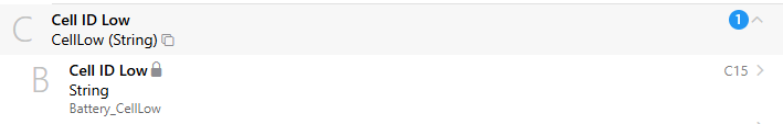

This is the result
Corrected: missed the n
But it still not work
When I create a MQTT channel via UI I can add JSONPath and JS
When I use your definition it looks so
My fould
I should wait until the system have complettly load the thing file
Now it works like a charme
