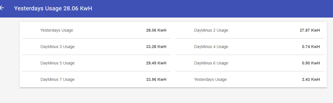

The picture inserted also shows how a bug would look since the cron rule triggered at midnight and then for some reason it triggered again at 1am.
