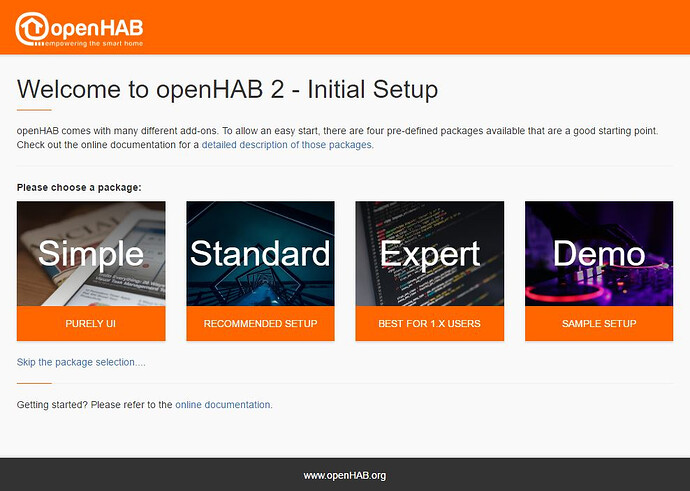

open in web-browser localhost:8080 and select a Package.

I only know the following packages:
simple
standard
expert
demo
see here:
