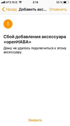

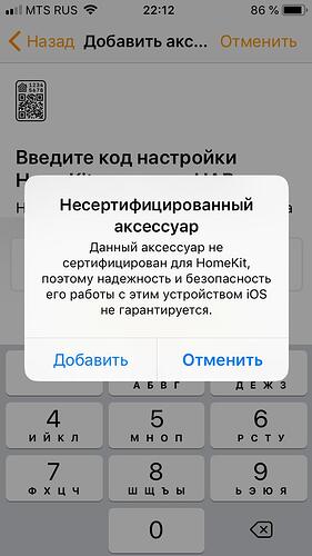

As a result, SmatHome finds the device OpenHab requests a PIN code. After entering the pin code my phone gives an error in which it says that it can’t add the device.
in the log file we have the following:

your configuration looks good.
potential issue could the “NULL” state of your items. it was actually fixed already a longer time ago, but who knows. so, if you have sitemap - please click on every switch you have (turn them on and off) or you can use karaf to send ON command to your items.
please also make a screenshot of iphone which you get after the screenshot you have posted. what happened if you click on “Добавить”?

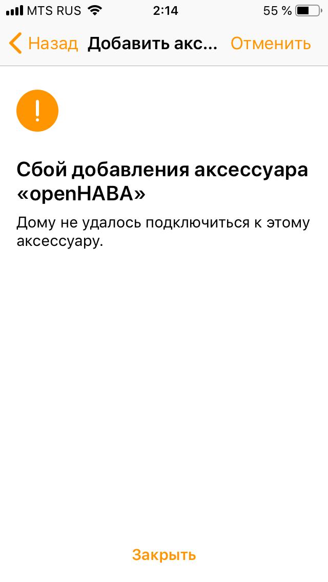

After when I switched the switches to Basik UI. Warning messages in the logs have disappeared.
But the switches weren’t added to my phone. Now the logs are clean, but there is no OH2 connection with the phone.
Thanks for the advice! I fixed my message.
@Shkiper is it working now ? can you see switches in home app? if not, try to delete home in home app, restart the iphone and add it again.
Hello! I didn’t succeed. ;-( I do not cherish when it is necessary to do incomprehensible operations like dancing with a tambourine. :frowning: Tell me where to dig further. I understand that you need to enable debugging mode and look for the reason. People, please direct me along the right path, help me not to waste time on wrong actions! Thank!
to me it looks like an issue in iphone.
  • which iOS version you have?
  • do you have apple tv at home (it acts as homekit bridge and makes sometimes issues)
  • do you have some other homekit device already connected to home app directly, without openHAB?
  • have you tried to delete “home” in the home app, restart iphone and add home again?
  • is authentication enabled, i.e. smarthome:homekit allowUnauthenticated false
