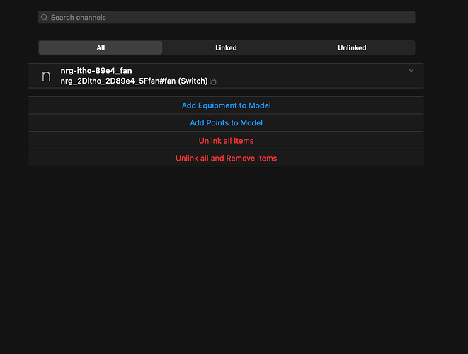

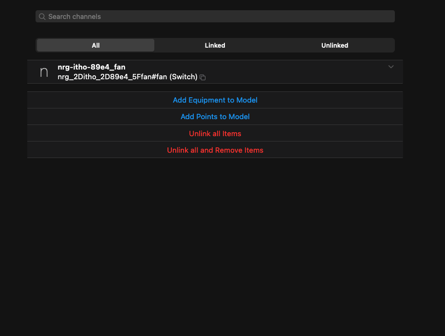

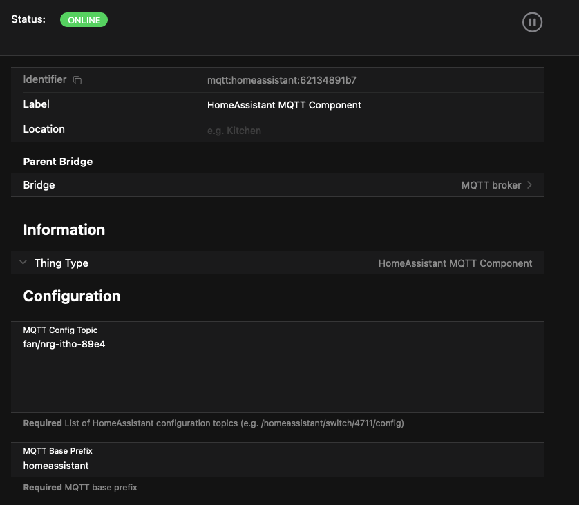

I have also the option to configure HomeAssistant MQTT in my device. I get the first part of below string. It creates one channel, the other channels are missing.. :frowning: What do i wrong?
{"dev":{"identifiers":"nrg-itho-89e4","manufacturer":"Arjen Hiemstra","model":"ITHO Wifi Add-on","name":"ITHO-WIFI(nrg-itho-89e4)","sw_version":"HW: vNON-CVE 1, FW: 2.3-beta2"},"avty_t":"itho/lwt","uniq_id":"nrg-itho-89e4_fan","name":"nrg-itho-89e4_fan","stat_t":"itho/lwt","stat_val_tpl":"{% if value == 'online' %}ON{% else %}OFF{% endif %}","json_attr_t":"itho/ithostatus","cmd_t":"itho/cmd/not_used/but_needed_for_HA","pct_cmd_t":"itho/cmd","pct_cmd_tpl":"{{ value * 2.54 }}","pct_stat_t":"itho/state","pct_val_tpl":"{{ ((value | int) / 2.54) | round}}"}
What i Get is this:

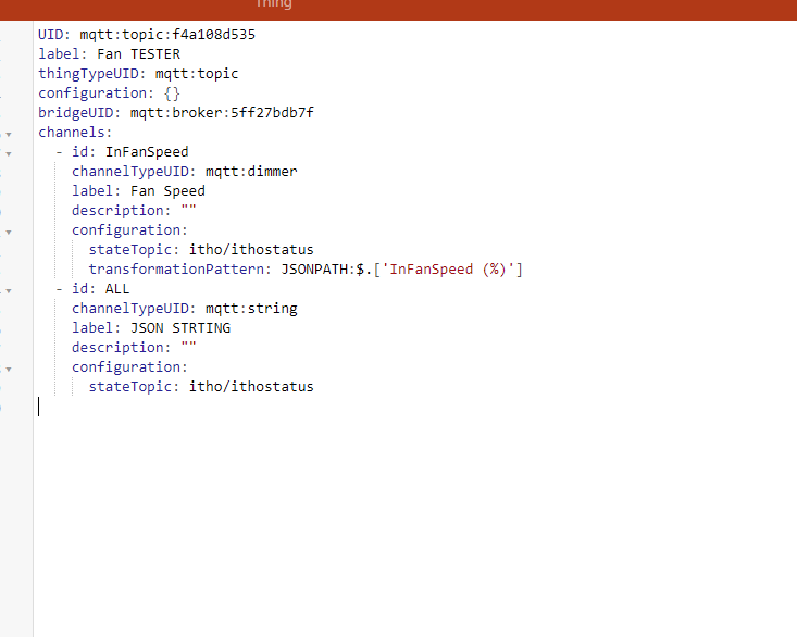

transformationPattern: JSONPATH:$.['InFanSpeed (%)']
This will work.
First create a couple of channels then you can add them in the code tab once you see the structure.
yes, worked really well! thx
