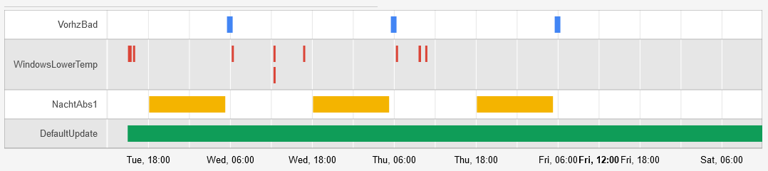

Rules
On top of this one can define heating rules with the following features / attributes:
  • temporal scope: active from and to (relative to either recurring events like a wake up time or an absolute date-time)
  • priority: using a number to resolve rule conflicts
  • affect on heating pairs (i.e. what to change)
    • by referencing any number of rooms and/or heating pairs via string matching these can be selected
    • an abolsute or relative temperature change can be applied
    # A rule (heating extension)
    Wiregate::CrossPlugin::HeatingExtension->new (
        'SwitchOff', 'Alles (fast) aus',			# id, name
        # Note that the month starts with 0 (i.e. substract one...
        WG_RT_SPECIFIC_DATETIME, timelocal(0,0,8, 19,3,2019),	# active from
        WG_RT_SPECIFIC_DATETIME, timelocal(0,0,9, 27,3,2019),	# active to
            # change temp for all heating pairs in all rooms to 17 degrees absolute
            { room => '*', hp => '*', temp_abs => 17 }
        100					# Priority 100 (rather high)
    # A second rule - with relative time to a recurring event
        'Nachtabs', 'Nachtabsenkung',		# id, name
        WG_RT_GODNIGHT_TOMORROW, -30,			# from ref, offset mins
        WG_RT_GETUP_TOMORROW, -45,			# to ref, offset mins
            # Changes applied to specific rooms and heating pairs with
            # different target temperatures
            { room => 'EG-WZ', hp => '*', temp_abs => 20 },
            { room => 'UG-KO', hp => '*', temp_abs => 19 },
            { room => 'EG-AZ', hp => '*', temp_abs => 20 },
            { room => 'OG-BA', hp => '1', temp_abs => 21 },
            { room => 'OG-BA', hp => '2', temp_abs => 21 },
            { room => 'OG-KN', hp => '*', temp_abs => 20.8 }
        ],	# array of changes
        0	# Rather low prio
# More rules follow ...

For the implementation I decided to use JSR223 Jython. I tackled the part for evaluating / defining the target values first. So not the actual controller that then tries to regulate actors to reach that target value. I assume besides rlkoshak pull request to the jsr223 helper libs, there may be further implementations out there that can be used. Or - as @rlkoshak pointed out, one might use a more reliable platform for the actual controller part.
The ideas contributed by @5iver, @rossko57 and @vzorglub using item meta data / nested groups for configuration purposes sounds quite interesting. But for the start, I just coded the config directly in the script.
The first version
Here are the key features for the first version:
  • Allow for setting target values…
  • Multiple elements (called meta blocks, I might need to fine tune the naming, though) can be defined to affect the target value of a given open hab item (for example: “Lower temperature during night time”).
    • The meta blocks can be prioritized against each other.
    • The blocks (“meta block specific instances”) have a start and an end.
    • Meta blocks can have a schedule (think cron like but… with an end or duration).
    • A block can influence mutliple OH target items with different effect (e.g., set different values for bed rooms versus bath room).
  • A dynamic element can be used to lower the target value on events (e.g., when a window is opened).
  • No periodic evaluation but only when needed.
  • There is a rudimentary visualization of these meta blocks
For some days, I observed the values generated now and I’m satisfied. Of course there are still multiple things to take care of. But next I will actually setup a controller and have it control my heating.
The first version I created, is available via github: GitHub - Urmel/PaT3S: Priority and Time Span Support for Scheduling (PaT3S). It features a Readme which goes into much more detail along with a sample configuration.
As a teaser, here a live snapshot from the rather rudimentary visualization of these meta blocks which I have in my sitemap:
