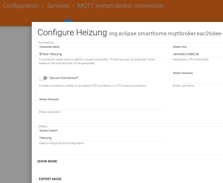

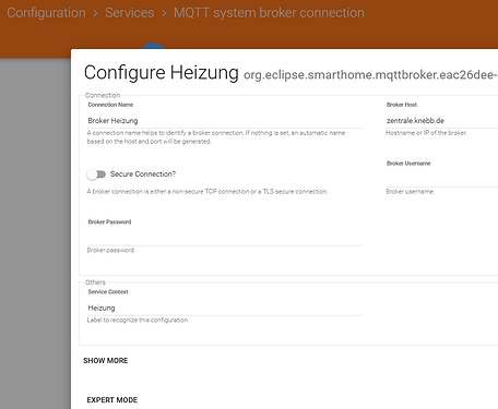

First, the broker settings:

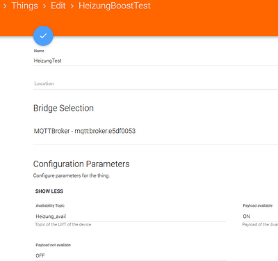

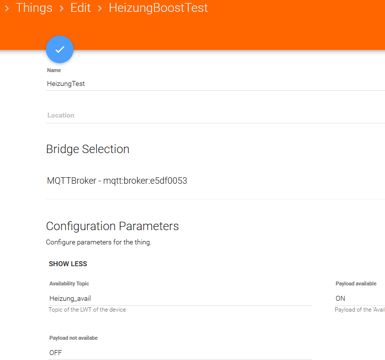

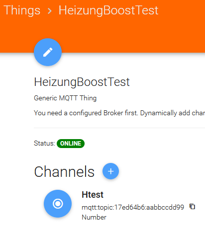

These are the thing’s settings.
I configured the LWT topic for availability ON/OFF and it works just fine when publishing “ON” or “OFF” through mosquitto_pub -t "Heizung_avail" -m "ON" -r.
See log:
2021-01-11 12:34:26.374 [hingStatusInfoChangedEvent] - 'mqtt:topic:17ed64b6' changed from OFFLINE to ONLINE

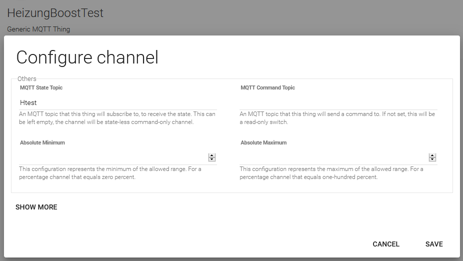

Now this is how it looks in the channel configuration for the thnig:
And the channel configuration is this. I did not configure any additional stuff:

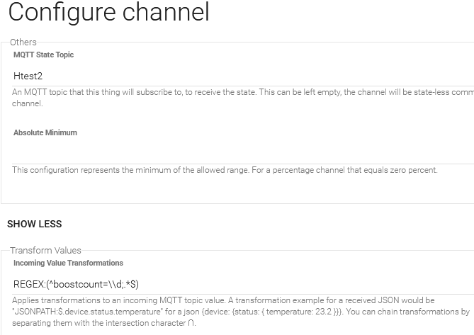

I am only interessted in the number of the “boostcount” value so I added a REGEX to the channel settings (REGEX transformation is installed):
Unfortunately I does not appear to be working for a reason I do not get. Someone having examples how to use the REGEX stuff here?
I alreaady tried:
REGEX:(^boostcount=\\d;.*$)
REGEX:^boostcount=\\d;.*$
REGEX:^boostcount=\d;.*$
REGEX:boostcount=\\d
None appears to be working, instead I see in the log:
2021-01-11 12:55:49.572 [WARN ] [ab.binding.mqtt.generic.ChannelState] - Incoming payload 'boostcount=0' not supported by type 'NumberValue'
Any clue?
/KNEBB
Ok, looks like I read too much. The REGEX-Documentation told me a different expression than I should use in MQTT bindung. Don’t ask me why.
However, the following works:
REGEX:^.*boostcount=(.*)?;.*$
