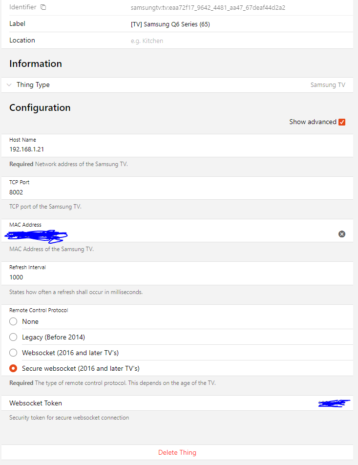

@Rickytr ,
The update cycle is irrelevant to almost everything, it is literally only used to update Volume and Mute channels (and apps now but that’s a new thing). Correctly working UpNp is key to the binding working successfully.
You have some other issue going on. Can you post a screen capture of your Thing, and its channels, and the output of your log when you turn the TV on and off. please post the full log, it’s hard to figure out what is going on when you only post a small part of the log. You should see the UPnP devices appearing and disappearing as you turn the TV on and off.
If you don’t see them appear and disappear, there is some sort of network issue. Have you given the TV a fixed ip address? what about hard wiring the TV to ethernet? can you see the TV on a UPnP sniffer (I use uPnP Mate on my iPad, it will quickly show you what is happening with UpNp on your network).

Ive had my 2016 tv running on this app for a while now.
Connected using secure websocket.
Volume, input, all remote buttons etc work, the only thing is the power.
Only works if the TV is on and i turn it off.
If the TV is off and i try to turn it on, nothing happens. The TV is offline while its off.
Any way i can have this so i can turn the TV on using openhab, rather than manually?

Also, if I do not create my TV via the bindings file but via normal discovery.. where do I fill in the PAT?
I checked the advance box, but then I only see webtoken. Nothing else
@sintei ,
That doesn’t look like the latest binding. The latest binding shows the ip address on every line. I’ll check the download link isn’t pointing to the wrong file.
Can you set your log to TRACE, and post the full log? Your internal ip addresses are of no use to anyone by the way, you don’t need to remove them.
If you use a text file for things, you have to put the PAT in the text description of the Thing. You should be able to see it in the Thing configuration under advanced though.
What year is your TV?

Notice:
2021-12-08 17:35:34.341 [DEBUG] [tv.internal.protocol.WebSocketRemote] - 192.168.100.73: Remote channel connected. Token =
Has the ip address. Also, you have a number in the Token field (I assume 12345678 is not real) - you should not have a token in this field if you have accepted the remote access on your TV. It only appears the first time you accept the remote access, and then you would get a message saying Updated configuration - which you don’t have.
So this has to be an older version of the binding. The latest one is 154k in size (aprox). I checked the link, and it seems correct. can you try downloading it again, maybe dropbox took a while to update the file.
This is a brand new OH3 openhabian with one JAR inserted in it, the one from the download link.
Nothing else is installed.
The TV was autodiscovered.
When added the TV popup was granted to allow openhab.
The TV is a 2018 modell Samsung QN65Q6FN.
If I press advanced under THINGS on the TV, it only shows webtoken. There is no place I can insert PAT.
Here is the log file with trace with openhab restarted and TV scanned/found/added.
