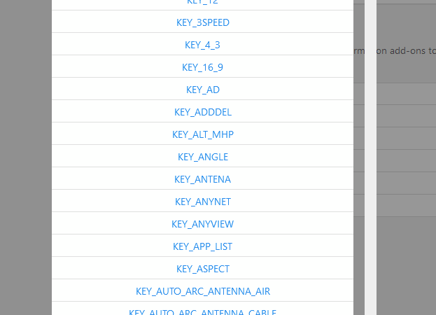

I’m still struggling trying to make my Samsung TVs work with openhab after the update to 3.1. I have two different devices: one QE55Q64 and one UE32 and neither is working correctly. The devices are not discovered automatically and also when using scan from the binding sometimes are discovered sometimes not.
When they are discovered usually the binding uses the 55000 port but it seems the channels are correctly updated only for some minutes. The thing remains online also after I power off the TVs and I receive timouts from ping. It seems the only way to update correctly things and channel is to start a new scan from the binding.
I’ve tried almost evrything I know (clear openhab cache and start with TVs on, start with TVs off and then scan etc..).
I’m desperately looking for help…

The problem isn’t with OH, caches or anything, the binding itself has a few kinks in it. One of those is that it doesn’t discover the correct configuration for your TV. You have to set this manually in the Thing.
The “channels” you see updating are mostly not real, they are just placeholders. The only channels you are likely to get are Volume and Mute, as these are UpNp services.
As I tried to explain in my long message above (and failed obviously), you have to select the right protocol/port combination yourself.
So, old TV’s (before 2016) use the legacy protocol and port 55000, 2016 TV’s and later use either the websocket protocol on port 8001, or securewebsocket protocol on 8002.
Start with the TV’s on (or the binding won’t find them at all - its not magic), add the Things when/if they appear in the Inbox, then configure the Things as I describe (I would start with securewebsocket and port 8002 if your TV’s are recent).
You will have to accept the connection on the TV when the “Remote Connection” box pops up on the screen - you have 30 seconds to do this from when you click “Save” on the Thing, or the binding won’t connect. If you miss accepting the connection, you have to try all over again. Nothing will work until you manage to click on the “Accept” connection on the TV. If you are sitting at your computer, and the TV is in another room, you may not be aware of the box appearing on the TV screen prompting you to allow openHAB to connect.
Another quirk of the binding is that you have to accept the connection (on the TV) every time you restart OH3, or add the Thing (if you delete it - don’t delete it!).
In addition, your TV’s have to be configured to accept remote connections. I don’t know what your menu’s look like, but usually there is a setting for “IPControl” and “External Device Manager”.
It would probably help me if you could post the output of http://<ip>:8001/api/V2/ where <ip> is the ip address of each of your TV’s. You can enter this in any web browser connected to the same network as your TV’s. You can try https://<ip>:8002/api/V2/ as well, let me know which works.
Let me know how you get on, it took me a while to figure it out, as I also assumed the Thing would be automatically configured correctly for my TV - and it isn’t.

Hi!
Maybe a bit offtopic but is it possible to add KEY_AMBIENT to the list of allowed/known/supported key’s?
My TV has ambient mode instead of artmode but the binding does not allow me to send “KEY_AMBIENT” to the KeyCode channel.

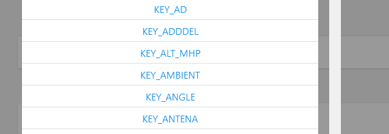

@tsmit
I already added KEY_AMBIENT to the updated binding I posted.

@tsmit
Sorry, added the KEY but forgot to update the descriptions. Added it now.
Try downloading again. Let me know if it’s OK now.
