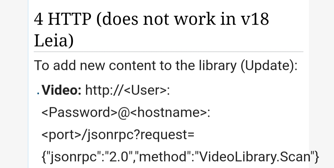

4 HTTP (does not work in v18 Leia)
To add new content to the library (Update):
http://<User>:<Password>@<hostname>:<port>/jsonrpc?request={"jsonrpc":"2.0","method":"VideoLibrary.Scan"}
I have entered it into my browser it does update my kodi libary how do i get openhab too send the request ?

Thanks rich I’m not sure I fully understand that but I will give it a try
Quick question it says that updating the libary using http will not be supported after v18 and that’s the next stable release should I just look at using one of the other methods they said
I would. They are definitely saying it won’t work after that point so I wouldn’t waist your time. I don’t use Kodi so I couldn’t tell which of their other approaches are reasonable. But I can say using curl is just making HTTP calls so that won’t be an option.

I read that to mean in version 18 the HTTP interface will no longer work. The following two examples ARE HTTP so it is telling you that these two examples will no longer work when you get to v18.
Nope. There is no difference (from Kodi’s perspective) between a browser or curl hitting that URL. It’s all an HTTP GET call and both have the user and password as part of the URL (it’s called Basic Auth).

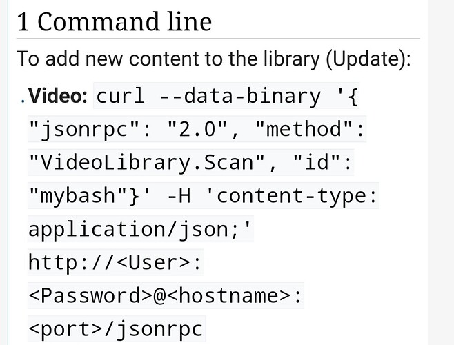

Please follow the last link in the HOW-TO: JSON-RPC API. Kodi supports two different interfaces. A HTTP API and the newer JSON-RPC API. First one will be deprecated in v18. Second one is a HTTP- and/or raw TCP socket-based interface. Meaning curl request are possible but with a different syntax than before. If you read carefully through the examples you can see the difference.
Using HTTP Basic Authentication is IMHO a bad idea. But using curl should be the way to go. Please try something like this:

I will have a look into using a curl request but this is the first time I have tried this so…
@cweitkamp sending that from openhabian command line worked perfectly thanks for that
