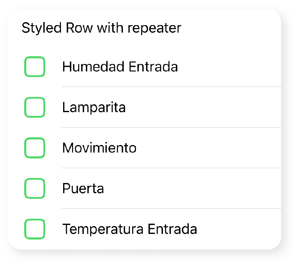

There are some things I’d like to change but I don’t know how. This is how the widget looks in a computer:
And this is how it looks in an iPhone:
  • As you can see, the card title is bold in the computer but not in iOS. How can I make it bold in iOS?
  • How can I remove the line between the title and the content of the card?
  • How can I remove the lines between the repeater items?
  • How can I increase the left padding of the repeater items?
Thank you.

Thank you, the padding works perfectly, but I haven’t maged to remove the hairlines or make the title bold in iOS.
If I add “font-weight: var(–f7-card-header-font-weight)” to the style section of the f7-card all the card becomes bold. Where should I add it?
And for the hairlines, I tried to add the class “no-hairline” to the f7-card but it makes no difference.
Regards.
Right, that’s how css works. When you specify a value for a property all children of that element inherit that property value unless something else explicitly set a new value. So if you just set font-weight on the card then every child of the card that doesn’t have its own definition for font-weight will get that one. It doesn’t say so on the card css docs, but it’s possible that in iOS the default value for –f7-card-header-font-weight is different than on the other platforms. Try just explicitly overwriting that variable in the card style to eradicate the iOS specific default.
--f7-card-header-font-weight: 700
That’s odd. That class should work for cards. I wonder why it’s not working. Anyway, you can also try to add to the card style:
--f7-card-header-border-color: transparent
--f7-list-item-border-color: transparent
Perfect! Once again: THANK YOU!!!
