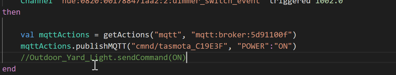

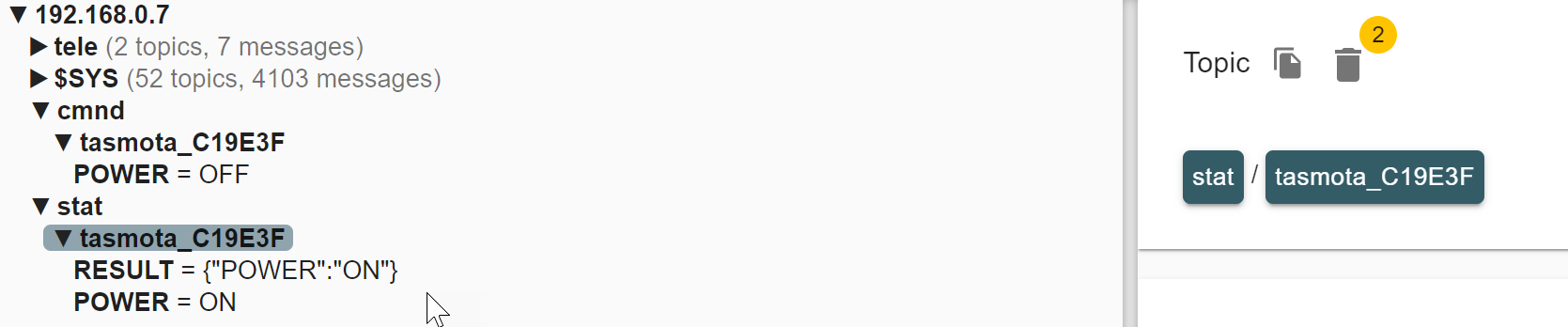

MQTT explorer sees the message and light goes on and off from cntl panel and console
Haven’t got a clue on sending a command. Kind of thought the whole idea behind items was to abstract the thing but the basic “sendCommand” doesn’t seem to work?
Anybody got any examples for helping me?
Solution: I was suspicious that an item was created to abstract the physical layer(thing). Indeed, that was the case. The “thing” was working correctly from the control panel and the Basic UI but I couldn’t get a rule to work. Simple, just send it a command and let the thing take care of the correct messaging!

Regarding the use of MQTT action in a rule , as posted by @H102 you do not need the action for the purpose you are trying to do. It doesn’t work because you are sending a “stat” message which should be posted by the device. In order to command a switch you would need a “cmnd” message to the topic " cmnd/tasmota_C19E3F/POWER" with the content “ON”.

Thanks, maybe I was not totally clear, my fault. I have the ability to turn on and off the thing with an mqtt message and I can use the control on the paper UI to turn it on and off. I know it is getting the correct message because the MQTT explorer is showing it. What I can’t figure out is how to send the “item” a command like on or off. There is some stuff in the docs about mqtt actions etc but don’t get that to work. Do I simple send the item a command, or must it be in the mymqtt actions format?

In addition to what @rossko57 posted, the mqtt action in a rule would be needed if you do NOT have a çreated channel.
