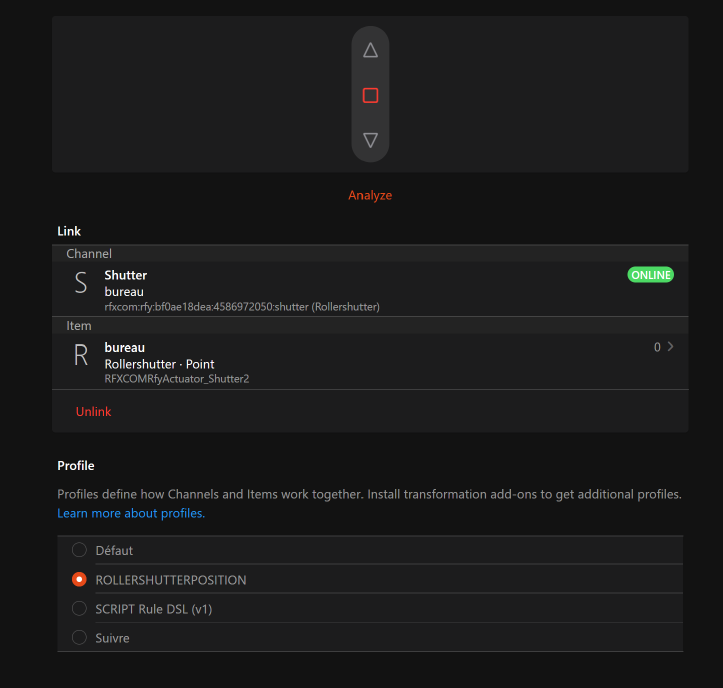

As you can see when I select ROLLERSHUTTERPOSITION in the UI I cannot configure it (nothing is appearing at the bottom)
Again, you need to configure the items via textual definition. It does not work in the “UI only way”
indeed, it worked by adding a text definition of the item !
