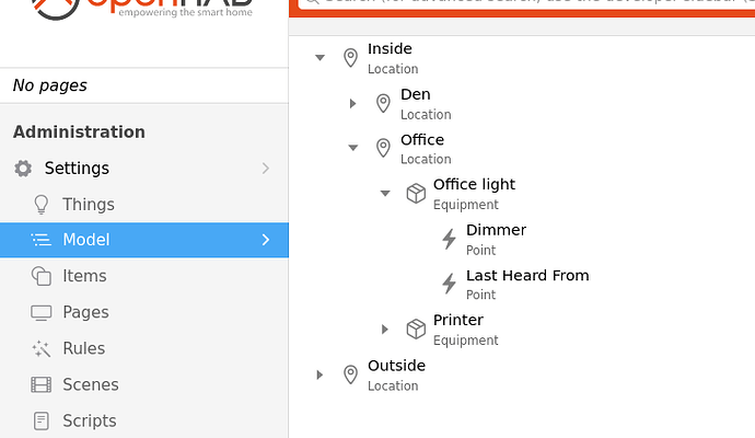

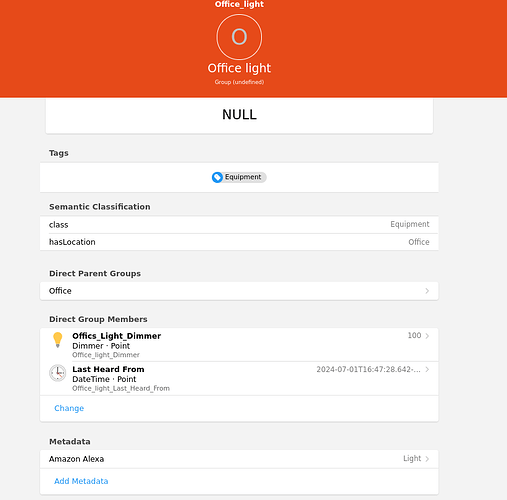

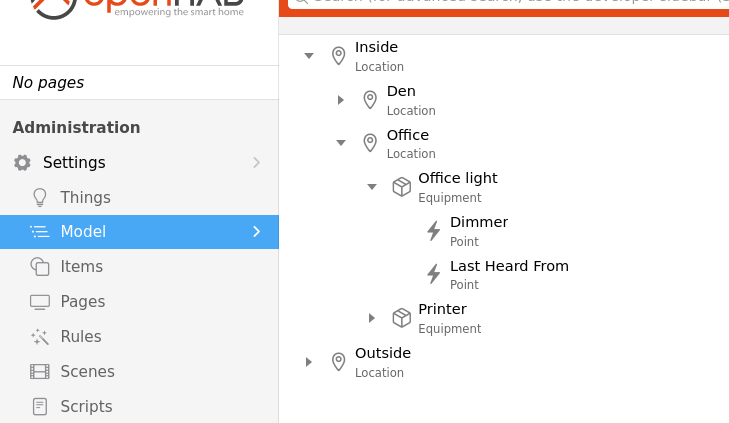

I’m finding setting up the Alexa skill to be very confusing. I’ve read the docs but I think I’m missing something important. I have a light on a dimmer switch that I want to control via Alexa. I can control it via the OpenHab app so I know that it set up correctly. Here is my very simple layout

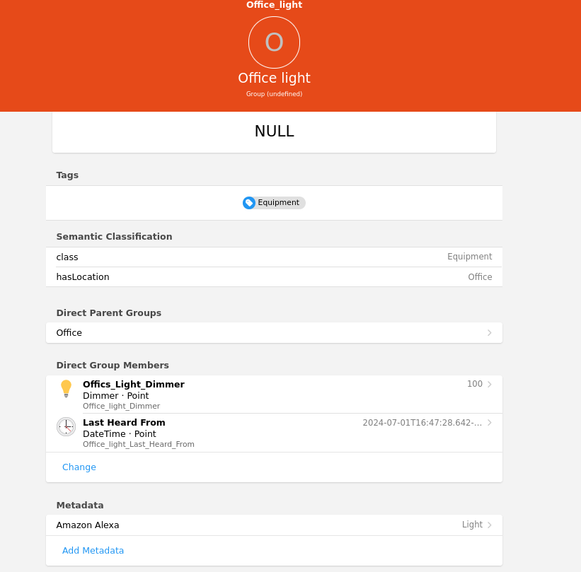

If I select the Office light item it looks like this

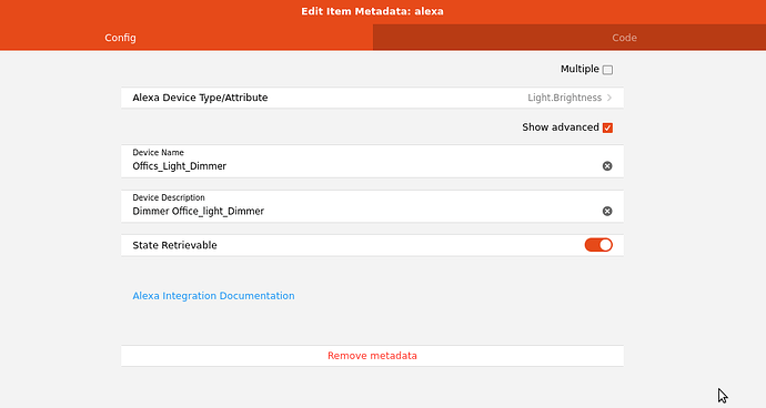

I selected Add Metadata and I get this:
but even after I have saved this the code tab is empty

As far as I can see from a quick check you’re missing the Alexa metadata for the dimmer item. You have to add that first. Then add the metadata for the group and openhab shows the recognized sub-items.

In your last example I’m not sure "Office_Light_Dimmer will work for the Name .
The Name will be in the utterance so I’m not sure how you would say that name to Alexa. Why not just call it Office Light?

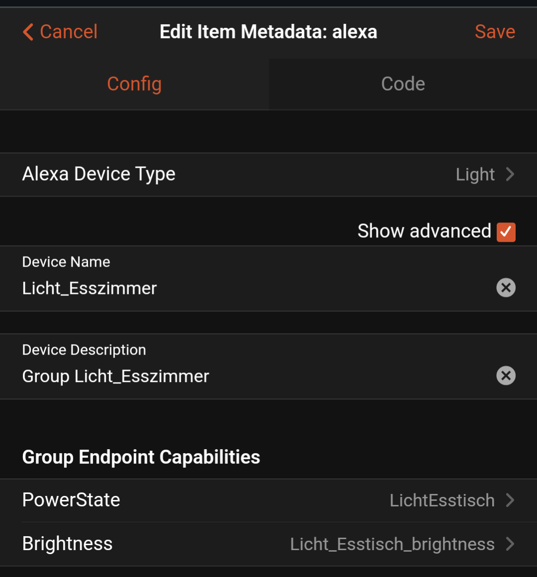

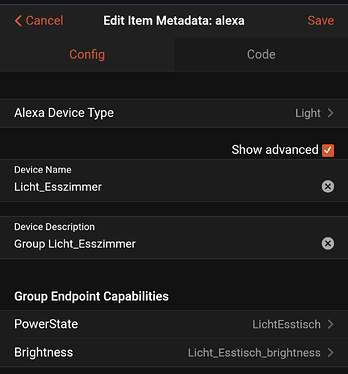

My dimmer group contains a switch and a dimmer item with metadata like this:

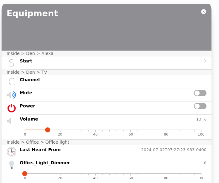

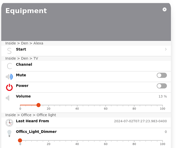

The Alexa app? Do you mean the OpenHab app or just the myopenhab.org site. It looks like this:
on https://home.myopenhab.org/equipment#card=Equipment and I can just drag the slider to turn it on.

There is no need to expose a group endpoint if you are only exposing one attribute. So for your use case, you should only expose your Office_Light_Dimmer item as a Light single endpoint. No need to configure the group.

That’s because you setup your Office_Light_Dimmer item with the Brigthness attribute only. As I mentioned above, you should directly setup that item as a Light single endpoint and remove the metadata configuration at the group level.
