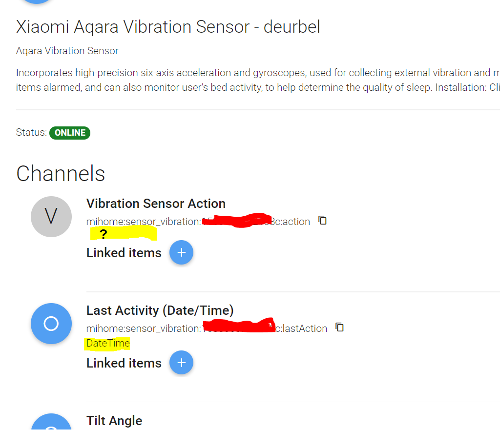

I have a channel “Vibration Sensor Action“ but I don’t know what type this is and how to use it!?
mihome:sensor_vibration:xxxxxxxxxxc:action
any advice on what and how to use this device?
maybe it is better to use “Vibration Sensor Action“!!!???

Any idea how to create a item for “mihome:sensor_vibration:xxxxxxxxxxc:action” with out knowing the type e.g. number, string , switch or date/time ?
What does PaperUI tell you about it?

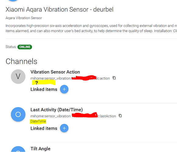

Hi Ross ,
As you can see nothing, where other channels show a type the one for Vibration sensosr action is empty
xiaomi
strange!
Oh, it’s an event (trigger) channel.
You cannot link that to any kind of Item directly.
You can listen for the event in a rule trigger, examples of that are shown in the binding docs.
