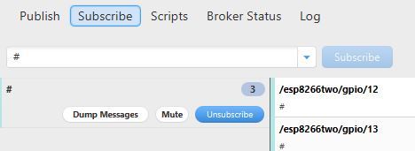

Subscribe to topic # and you will see every device message coming in …
As @sihui said. You can also subscribe to e.g. +/Sonoff_2/# to see everything related to this one device.

Ah one more thing @deltabert and @sihui I’ve used mqtt.fx for a longer time and I really don’t like it :smile: If you feel the same way, check out mqtt spy.
Thanks sihui, but i alraedy did that; in fact i started with #. But then you get a lot of other mqtt msgs and i just want to search for specific messages, like all my sonnofs ( Sonoff_*/# ), or better still specify one specific sonoff ( Sonoff_2 )
