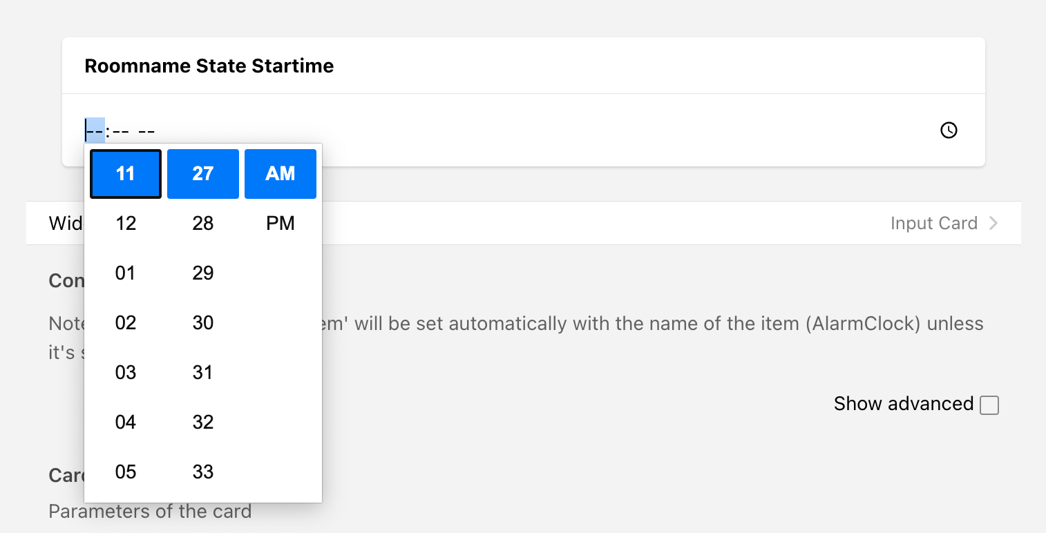

- Create a separate DateTime Item for each room and each time state (i.e. TimerMorgensan, TimerMorgensaus, etc.). This assumes that each room has a different set of times. So if you have four rooms and four states, you’d have 16 Items.
- Use an input card with the “type” set to “time” This generates a widget that looks like this.
If these Items are in the semantic model, they will automatically appear on the locations tab of the Overview Page in the right rooms. Otherwise I’d crate a page for them to have a place to edit them. But the semantic model makes it really nice, the UI creates itself.
