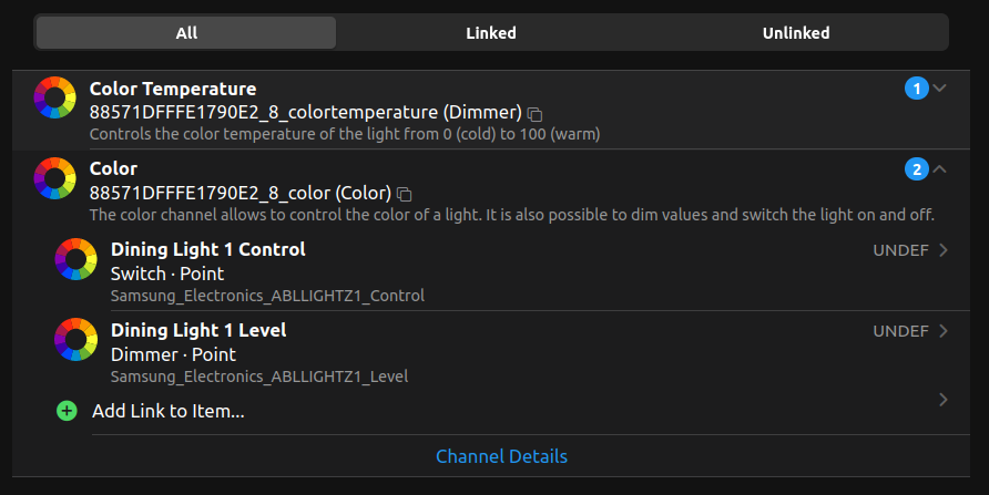

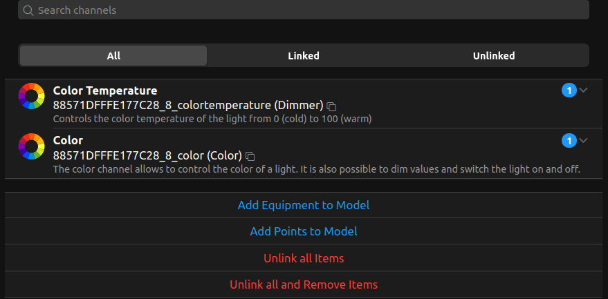

I see two channels in the thing config as seen in picture below:
The first channel is controlling the color temp perfectly from cold to warm. But I have not been able to get the (dimmer like?) second channel to control brightness and on/off for these lights. Could someone please point me in the right direction here to get the on/off and brightness control.

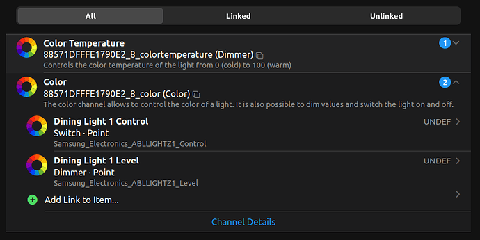

You need a separate item for each of these things, so your Color channel will be connected to:
  • a number item for color value
  • a dimmer item for brightness (0-100%)
  • a switch item for on/off
Thanks for the pointer, I created new items as you said and it works now :smiley:
As seen in this picture, the two items control on/off and light level. The color temperature channel controls the color temp from 3000k to 5000k via a dimmer item. These lights dont have RGB in them, so these are all the controls I need.
