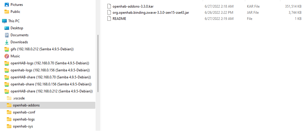

Probably most helpful is if samba was setup by openhabian. I’m basically a windows person, so how to do some of this from the command line of the Rpi would be tough for me to explain since I don’t use that. Probably one of the linux people can help…
I have the key OH folders visible via the Samba setup on my windows machine and simply download the jar to my downloads folder and drop in the OH via file explorer
the folder is here(I believe this is a symlink location, but it should work.
edit: ZWave is case sensitive. I did it wrong the first time too
Oh. that is part of it. When I login to openhab it puts me in that home directory. I didn’t know I needed to be looking in /srv from the root dir.
I still need to figure out how to copy the file over there. I can ssh into the raspberry so that may be the easiest way. I’ll let you know.
