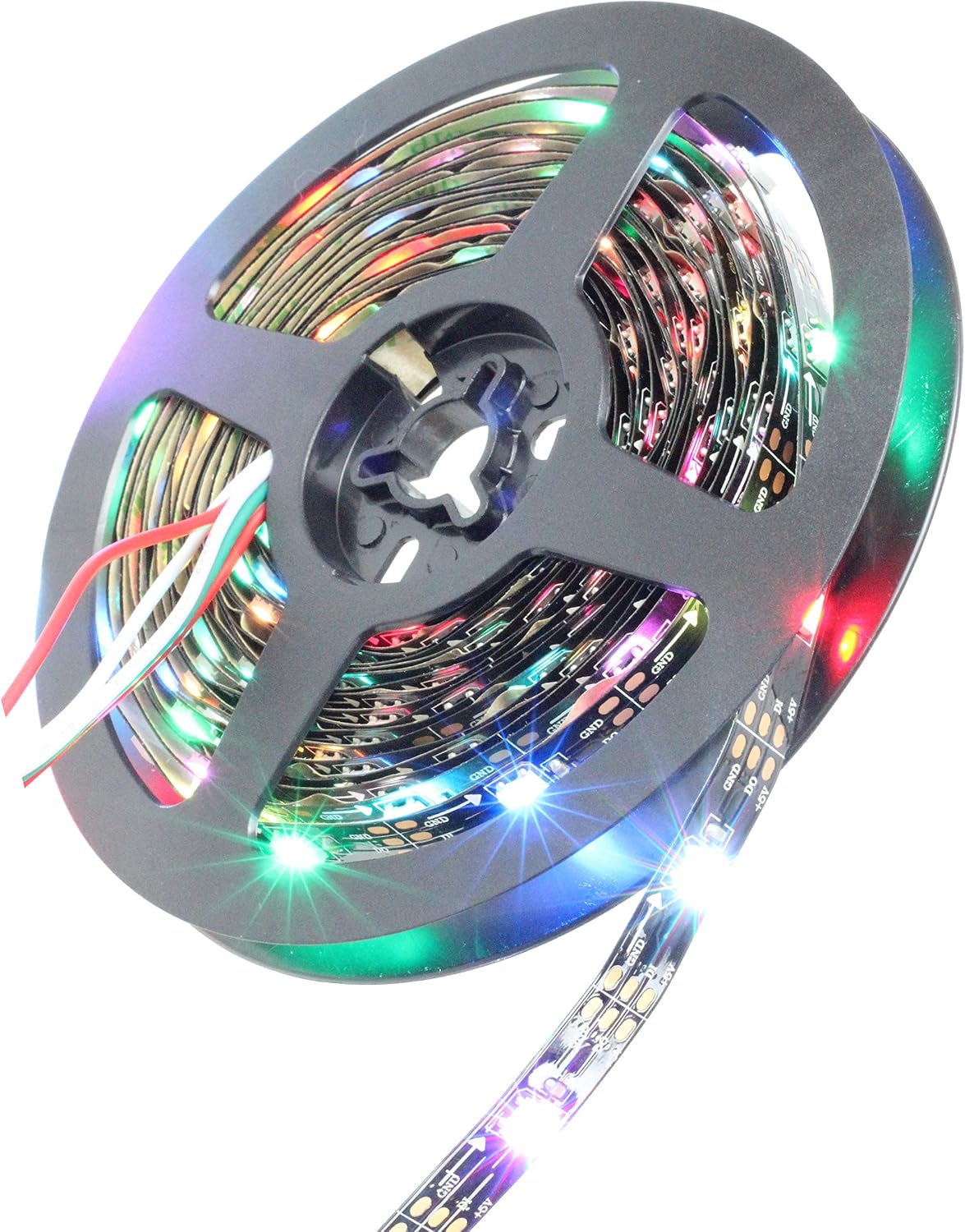

how does addressable work ?

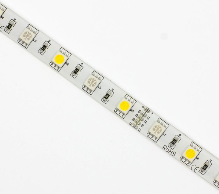

How do you know what strips are compatible alot of the ones I can find come with a remote to change colour
Any SMD 5050 with RGB and/or W will work. Each channel gets wired separately.
so you can buy the ones with the little remote and just throw all that stuff away keep the strip buy a ballast and a power supply

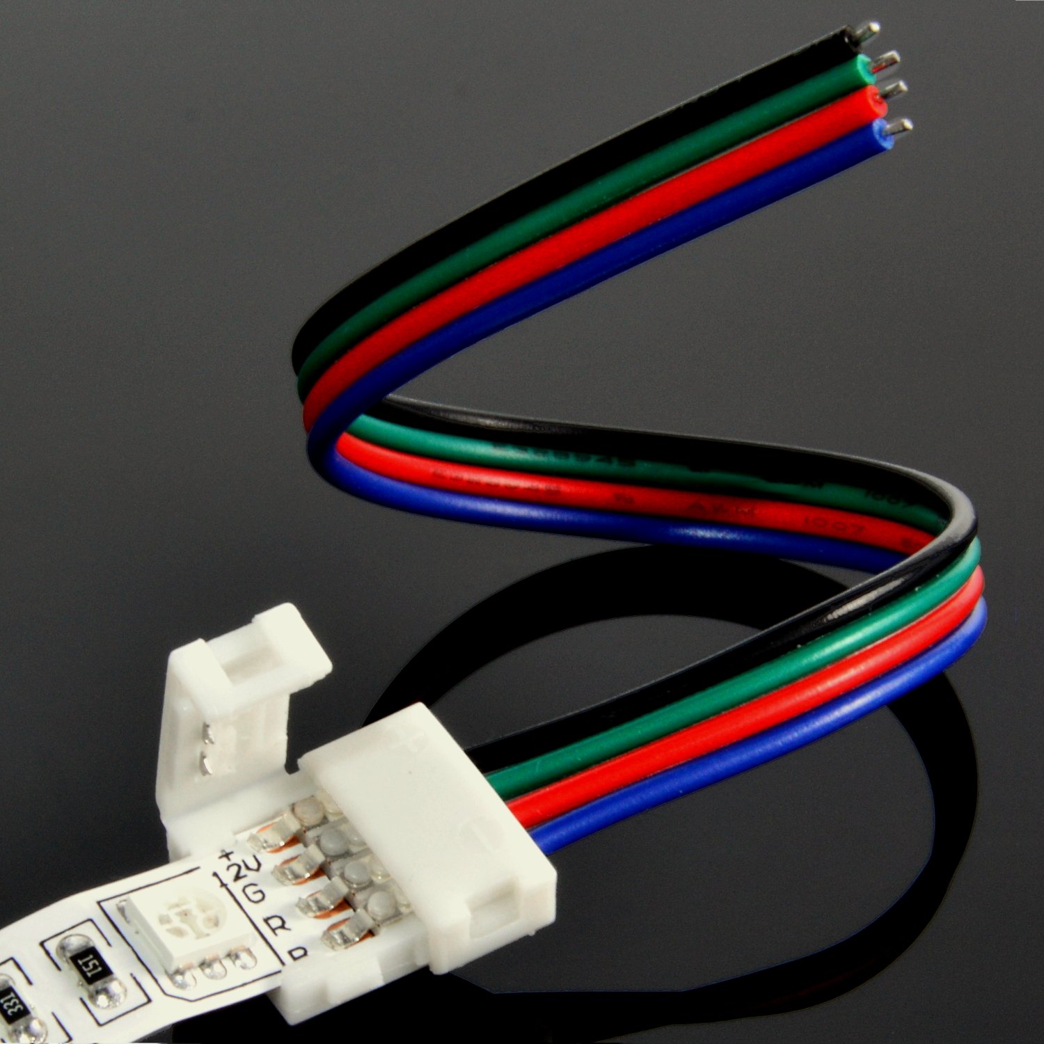

using one of these to connect the strip to the ballast ?

Hi again do you have the addressable functions working with openhab how do you send commands for different colour combinations ect
