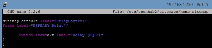

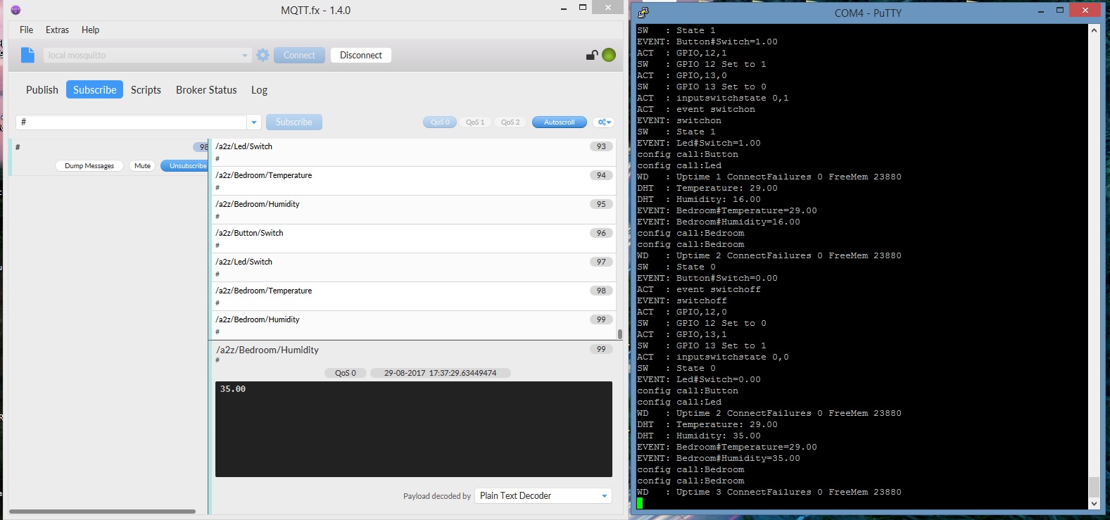

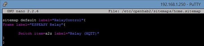

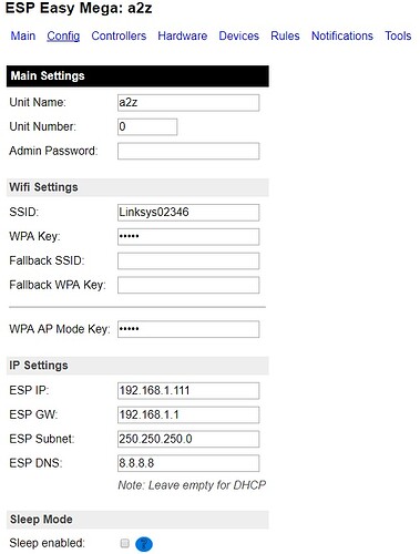

I try to build a basic project using espeasy + RPI3 with openhabian 2,1 and mosquito. everything is going fine but relay not working, I can turn on and off relay using espeasy commands using web browser all screens shots are attache can some one tell me where i am wrong.
additionally i want to add timer on this relay with save the relay state during power failure
@sny2ksa please read my earlier post
Thanks a lot andrew.
