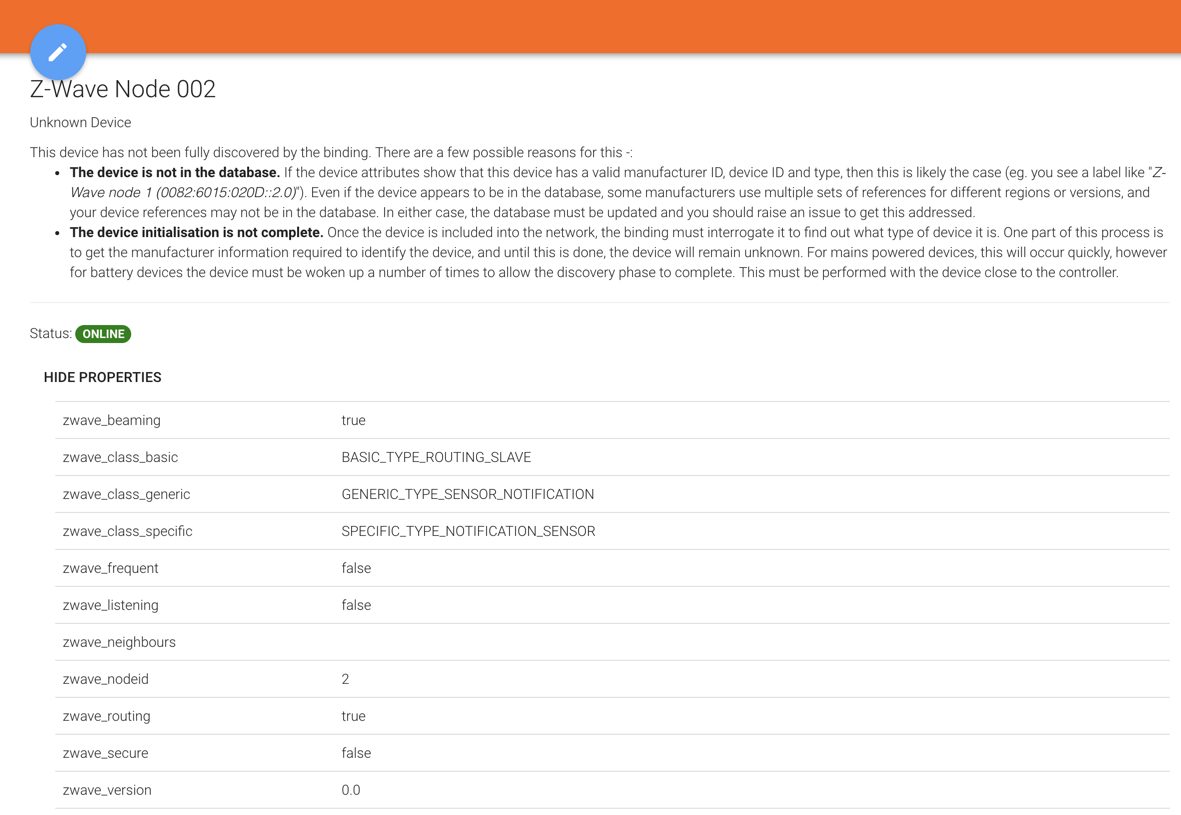

I updated as you recommended without any issues. I then removed all my z-wave things and even the binding, did a reboot - added back the binding and it found the z-wave stick immediatly. It seemed easier than adding it previously as it also detected and added the serial thing.
It found the sensor but this time I let it have reasonable amount of time to analyse it. I triggered the sensor a few times.
It still does not recognise it but the page of information seems a little more complete. Do you think this is progress should I look for a different brand of sensor. I went with the same make as the z-wave controller as it seemed the easy way to avoid incompatibilities.
That’s a new feature.
If it bears the zwave logo then it should be fully compatible with all other zwave devices.
Do you still see the “could not resolve to a thing Type” message in the logs?
@chris, @5iver, any ideas?

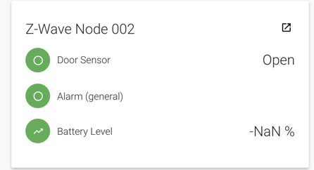

I did another reboot and watched the logs. Now it appears to be working. Phew.
I need to change its name but this is what I see in the logs.
2018-09-28 19:54:04.381 [vent.ItemStateChangedEvent] - ZWaveNode002_DoorSensor changed from CLOSED to OPEN
2018-09-28 19:54:06.299 [vent.ItemStateChangedEvent] - ZWaveNode002_DoorSensor changed from OPEN to CLOSED
2018-09-28 19:54:07.200 [vent.ItemStateChangedEvent] - ZWaveNode002_DoorSensor changed from CLOSED to OPEN
2018-09-28 19:54:08.025 [vent.ItemStateChangedEvent] - ZWaveNode002_DoorSensor changed from OPEN to CLOSED
2018-09-28 19:54:08.680 [vent.ItemStateChangedEvent] - ZWaveNode002_DoorSensor changed from CLOSED to OPEN
2018-09-28 19:54:09.260 [vent.ItemStateChangedEvent] - ZWaveNode002_DoorSensor changed from OPEN to CLOSED
2018-09-28 19:54:10.088 [vent.ItemStateChangedEvent] - ZWaveNode002_DoorSensor changed from CLOSED to OPEN
Thats probably all I can do today as it’s getting late. Tomorrow I will fix the sensor to the door and then I will need to look at rules and determine the best way to get alerted to the door being open, be that Google Home announcement (preferred) or iPhone app.
