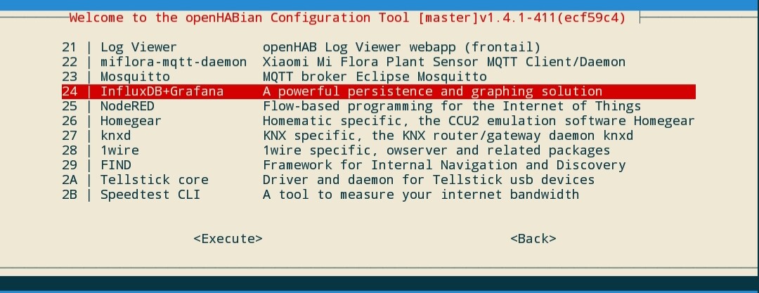

@sihui
It says that this will install influxdB and grafana but it can not like the two together at the moment please see a community post…
I’m assuming Openhabian is for beginners it makes getting oh running easy and has things like frontail smb shares ect already installed I’m sure you already know tho :wink:
Let me take my system offline and image my sd card :frowning: i always do before messing with important stuff
I will run the command and see what happens will post back
@sihui
I have Finished that now it said setup successful onscreen readings at bottom of this post
I’m not sure what too do next its directed me too the same post as you posted

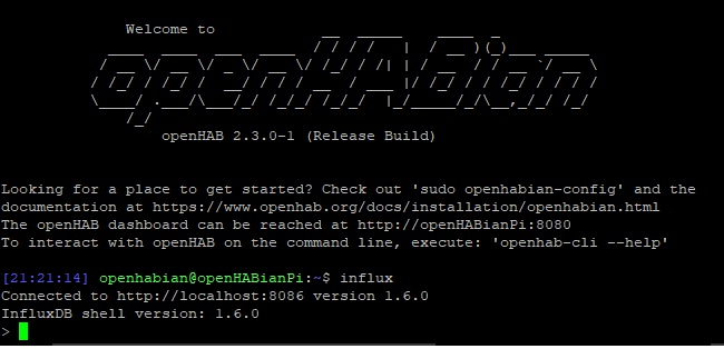

since you are in the InfluxDB shell I think you just type in the commands there.
Hi Rich
I have typed the commands there i wasen’t sure i was in the right place im still new too this
i Still cant access the web frontend for influx
grafana seems too be working not joined with influx but working
