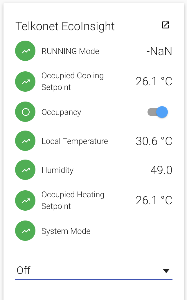

Hello, @chris. I’ve updated to a recent build (1549), which I think should include the aforementioned zigbee thermostat channels. I removed my Stelpro Maestro via Paper UI, stopped openhab, removed the zigbee xml file, restarted openhab, and re-discovered the device.
It shows up in the UI, but the only channel it sees is Humidity. This unit does have an issue where the name which is picked up by openhab has a bunch of garbage characters in it. That might be breaking the identification of device type?
I finally got around to testing this on my own thermostats. I can now see the setpoint via the ‘Occupied Heating Setpoint’ channel, but changing it has no effect on the actual thermostat.

I’ve just linked a thermostat, and while it looks like there are some issues (the mode doesn’t allow commanding, and the running mode seems to have an issue), however, in general it identifies the channels, and they are updated when I change the configuration on the thermostat itself.
I’ve had a look through your log, and don’t really see anything that should prevent your device working also - it’s identifying the same clusters as I’m expecting in the binding. So, I suspect that there may be an issue with your device and it’s possibly throwing an exception somewhere that is preventing the channels being discovered. That’s a guess since I don’t see anything in the log.
So, I recommend that we start with the latest binding - I’m just about to publish a new version in a few days. The latest version will resolve the issue with the corrupted device name - this was fixed a while back. I will try and resolve the issues I see here with the setting of the modes, and setpoints, Once we have that let’s see how we get on with finding the cause.
