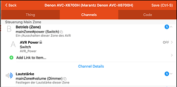

I don’t know how Marantz things look in openHAB - I just can say for my Denon: you need to add the Amplifier via “create thing” (in new Denon/Marantz AVR dialog), maintain IP address of Amp. and create afterwards ON/OFF switch in the channels of the amp.
For my Denon this is working fine.
