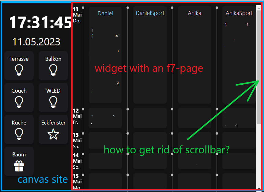

Hide scrollbar / make scrollbar more inconspicuous in widget with f7-page?
would like to know if the scroll bar (default on the right side) can be hidden with option in config, style or CSS stylesheet?
The canvas site contains an oh-canvas-item.
The oh-canvas-item contains the widget.
The widget contains an f7-page.
And on this f7-page I would like to hide the scroll bar.
I dont really know where to declare the hide option and which option.
Picture below.
Regards,
Daniel.

OK, that’s a little different. The widget you’ve got has an f7-page as the root component, but the f7 library will automatically add an additional element between that and the children components with a special class page-content. It’s that element where the scroll bar is added so you have to disable overflow scrolling on that element. The easiest way to do that is to add an additional directive to the stylesheet property that’s already defined for the f7-page of the widget:
component: f7-page
  style:
    --f7-card-bg-color: transparent
    noBorder: true
    noShadow: true
  stylesheet: >
    .timeline-item-content {
      flex: 1 1 10%;
    .page-content {
      overflow: hidden;
A word of caution: the scroll bar is only there because some content is, in fact, spilling beyond the bottom of the space. If you just disable the scroll bar instead of working out why the content is that long, you run the risk of losing information or functionality when something you want winds up hidden.

I don’t believe that anything has a class of scrollbar so you are not applying these directives to any element on the page. The element with the page-content class is the one that gets the scrollbar when your content gets too long, so that is the element you want to target with your css selector.
Yes, indeed. What a foolish try..
Thank you very much @JustinG
This below is excellent for me.
component: f7-page
  style:
    noBorder: true
    noShadow: true
  stylesheet: >
      flex: 1 1 10%;
    .page-content::-webkit-scrollbar {
      background-color:transparent;
      width:16px
    .page-content::-webkit-scrollbar-track {
    .page-content::-webkit-scrollbar-track:hover {
    .page-content::-webkit-scrollbar-thumb {
      background-clip: content-box;
      background-color:#babac0;
      border-radius:16px;
      border:5px solid transparent
    .page-content::-webkit-scrollbar-thumb:hover {
      background-color:#a0a0a5;
      border:4px solid transparent
    .page-content::-webkit-scrollbar-button {
      display:none}
    body {
      background-color:#000
    .page-content {
      overflow-y: scroll
    .overflow {
      min-height: 100vh
