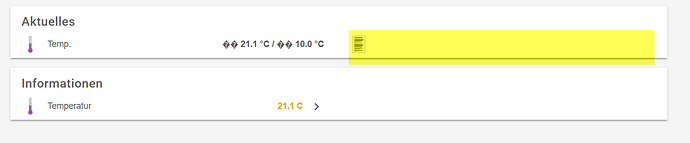

But it is not working. The string is empty but it is still visible:
