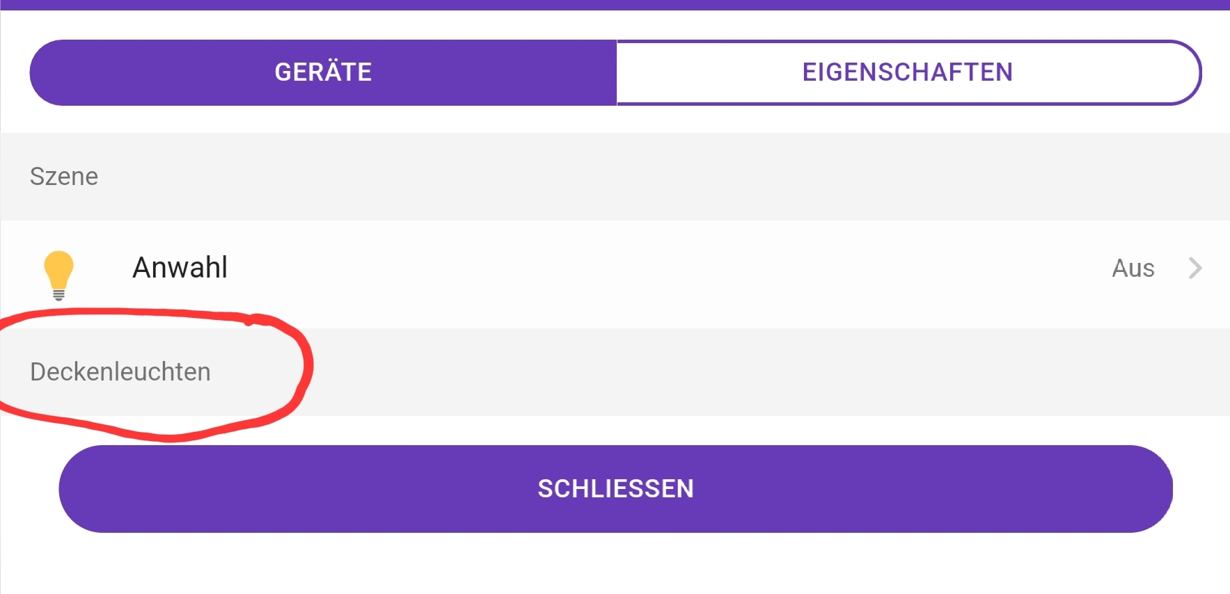

However, as I want to automate my home and not clutter it with every single control possible, I want to hide some things conditionally. That works for points.
Example: If the current point “scene” is not “Manual”, hide the controls of a given equipment “ceiling lamp”.
That works for the points, but an empty header for the equipment remains I cannot get to hide:
The metadata does not seem to work on equipment level to hide elements…
I don’t think this is possible.
Okay but it should, right? What is the point of an empty headline, or the visibility metadata at all?
Maybe you have equipment you dont want to expose to the user, but have it mapped in the model nonetheless. (See above, you don’t want to expose controls while they are automated in a home automation system).
Or is the locations card really just thought of as a kind of debug interface where everything is just available and I have to make my own pages from scratch?

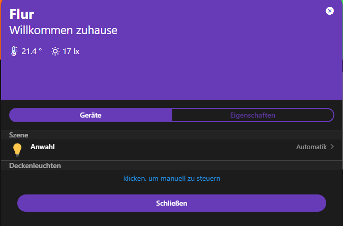

EDIT:
For anyone wondering:
I would have liked to completely hide it, but I went with the following:
“Click to control manually”. This switches the scene to “Manual”.
I really like your solution and I think it is by far superior to the approach of hiding stuff completely from the user. I think hiding stuff without telling the user how to make it visible again/what control hid the item in the first place does not make for a good user experience.
With my dining room lights I had a similar decision to make: the lights can switched off completely with a wall switch. At first I tried to hide the item completely like you just did. Since this did not work I decided to add a dummy switch item telling the user that the physical switch would need to be pressed to enable the controls. I think by explaining the reasons why controls are missing you can reduce the risk that users are getting the impression that controls kind of randomly pop up and disappear.
