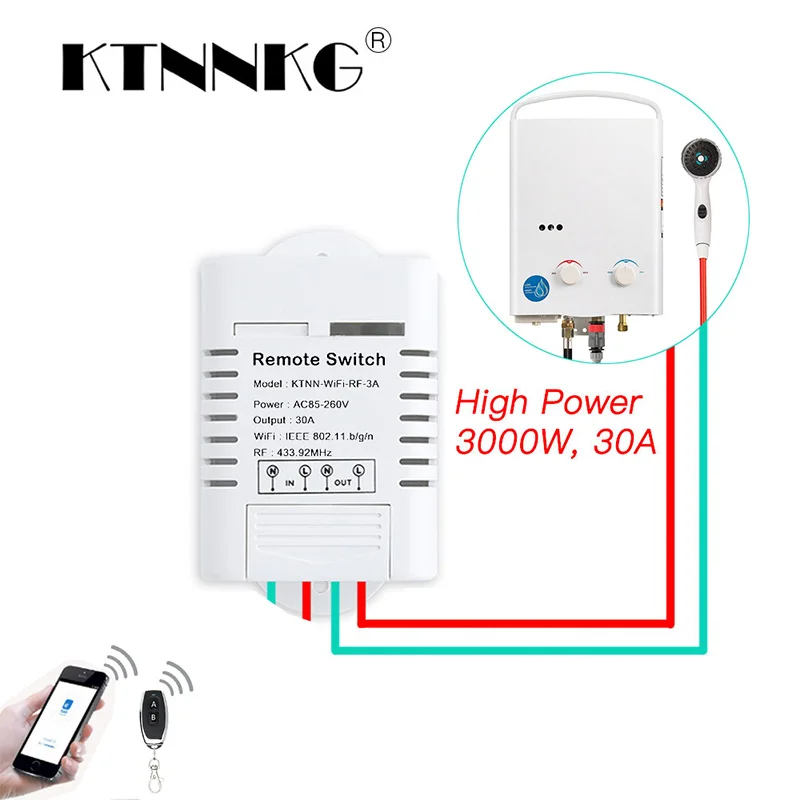

This should work for you:
That’s a nice option Chris. I did not realise there are higher power ones.
https://www.aliexpress.com/item/30A-Wifi-Relay-Switch-AC-110V-220V-1CH-DIY-Automation-Modules-Smart-Home-Receiver-and-Universal/32901481781.html?spm=2114.search0104.3.1.5bf64647ndn0t0&ws_ab_test=searchweb0_0,searchweb201602_3_10065_10068_10130_10547_319_317_10548_10696_10192_10190_453_10084_454_10083_10618_10307_10820_10301_10821_538_10303_537_536_10059_10884_10887_100031_321_322_10103,searchweb201603_51,ppcSwitch_0&algo_expid=ec383a68-2d14-4fbb-a805-101d54695546-0&algo_pvid=ec383a68-2d14-4fbb-a805-101d54695546
I wonder if one can flash it with custom firmware.
