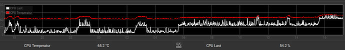

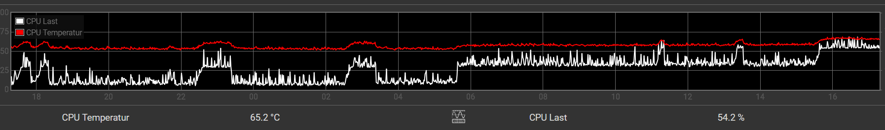

I have also migrated to the new hue ai v2. But also have the CPU peaks without the binding at all. The high CPU usage is not all the time. I have attached my CPU usage over the last 24 hours shown by the white line.
With version 3.4.4 I had only 5% CPU usage now over 50%.

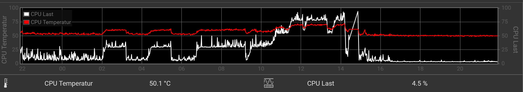

I switched back to the latest OH3 release. Same configuration as with OH4 (same amount of bindings, things, items and rules). Installed again Java 11 and have now back again my 4% CPU usage, CPU temp went down from 68°C to 49°C. Attached also the chart, switch to OH3 was completed at 4PM.
best regards René
