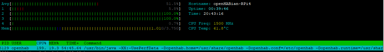

High CPU usage after migration to OH4
I have updated today to the new OH4 release. Now I have an high CPU usage. It has been moved from below 10% to 70% on an RPi wirh openhabian image. Is there any way to check which binding is using how much cpu power over the openhab karaf console?

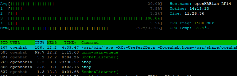

Can you change the display option in htop to show the thread names?
That makes it easier to figure out what is causing the load.

I have already the lateset openhabian version installed, so the Java Option “EXTRA_JAVA_OPTS=”-Xms192m -Xmx768m" in the openhab file was present already. I have changed the htop configuration. Main processes are now SocketListner and Yesterday also upnp-main-queue. With the old Java 11 and OH3.4.4 I had average load of 4% this year.

And from this list I would mostly suspect sonos. I also have wemo using a similar UPnP implementation.

With upnp remember that the size of the upnp network is very important. Not necessarily the size of what’s configured. Jupnp tracks ALL upnp devices on the network once it’s active even if they aren’t configured as things. It may be prudent to dial up the jupnp thread pools to see if theres a contention issue.

The reason why I mentioned sonos specifically is because of the thread name upnp-main-queue and the usage of openhab-transport-upnp in sonos, which I remembered.
